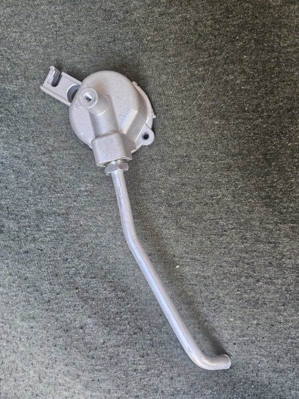

One of my first posts so I hope I'm not in the wrong category. My stove in a TAB 400 2021 has a broken gas nozzle (see photo). Can this be fixed by an RV dealer and if not, where could I buy a new one or have it fixed?
Your trailer probably has a Dometic stove. The model number may be on the under side of it. If you find it, you may be able to source the part on line from somewhere that carries parts for these stoves. Otherwise, a NuCamp dealer, parts department, should be able to acquire the part for you. Other forum posts have mentioned parts departments that are particularly responsive and will mail parts, if you need that. A Tab dealer would be preferable to make the repair, if that is what you want, but, yes, any RV repair service should be able to do it.
