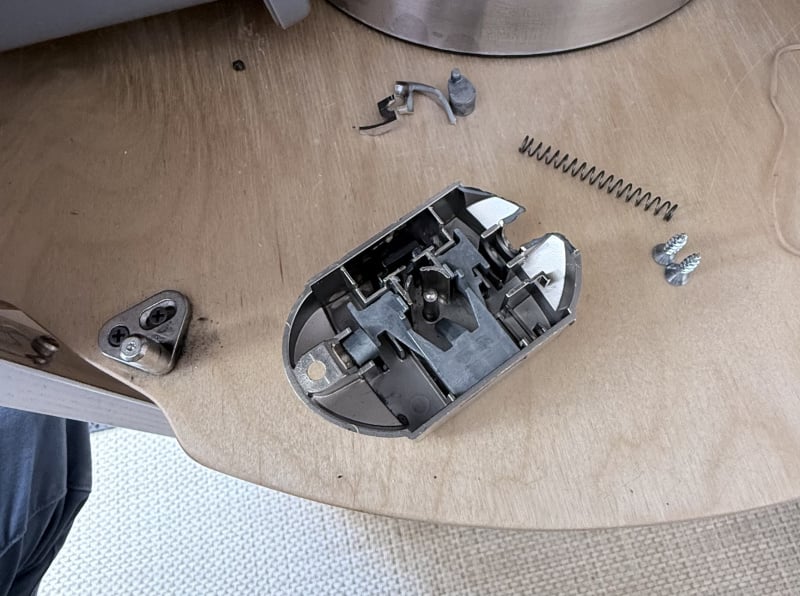

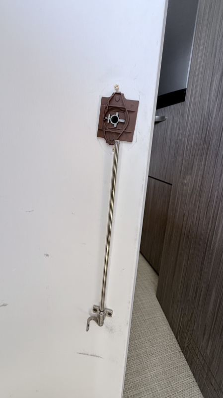

The hardware behind the push lock on the curved under sink cabinet door broke and NuCamp no longer sells replacement parts. Has anyone experienced the same issue and come up with a solution? Any ideas or suggestions will be much appreciated. Thanks.

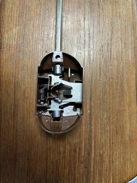

I also have a 2019 T@B 400 where the plastic of the latch broke where the screw holds it to the door. NuCamp said I needed part number 56-00-4383 which I ordered from my local dealer. The hole in the plastic where the bar goes into the latch was not there. After learning that the part for the 400 was no longer available, I ended up modifying the one they sent. The plastic is similar but a little different. You will need to reuse the two "round bits" where the bar goes in from your old latch.
Using an exacto knife I cut the plastic to allow for the bar to go in.

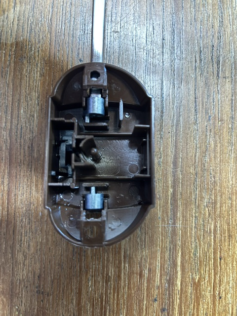

Note that the "knob" on the lower "round bit" is too long so I filed it down to fit. Make sure you file the correct one, they are not interchangeable. Here it is after filling it down:

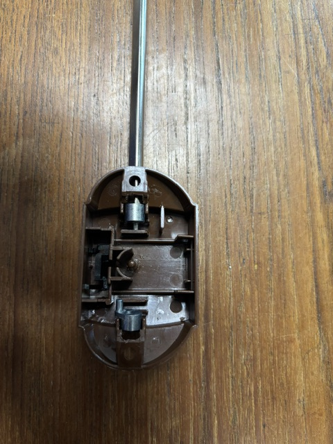

Ready to install:
