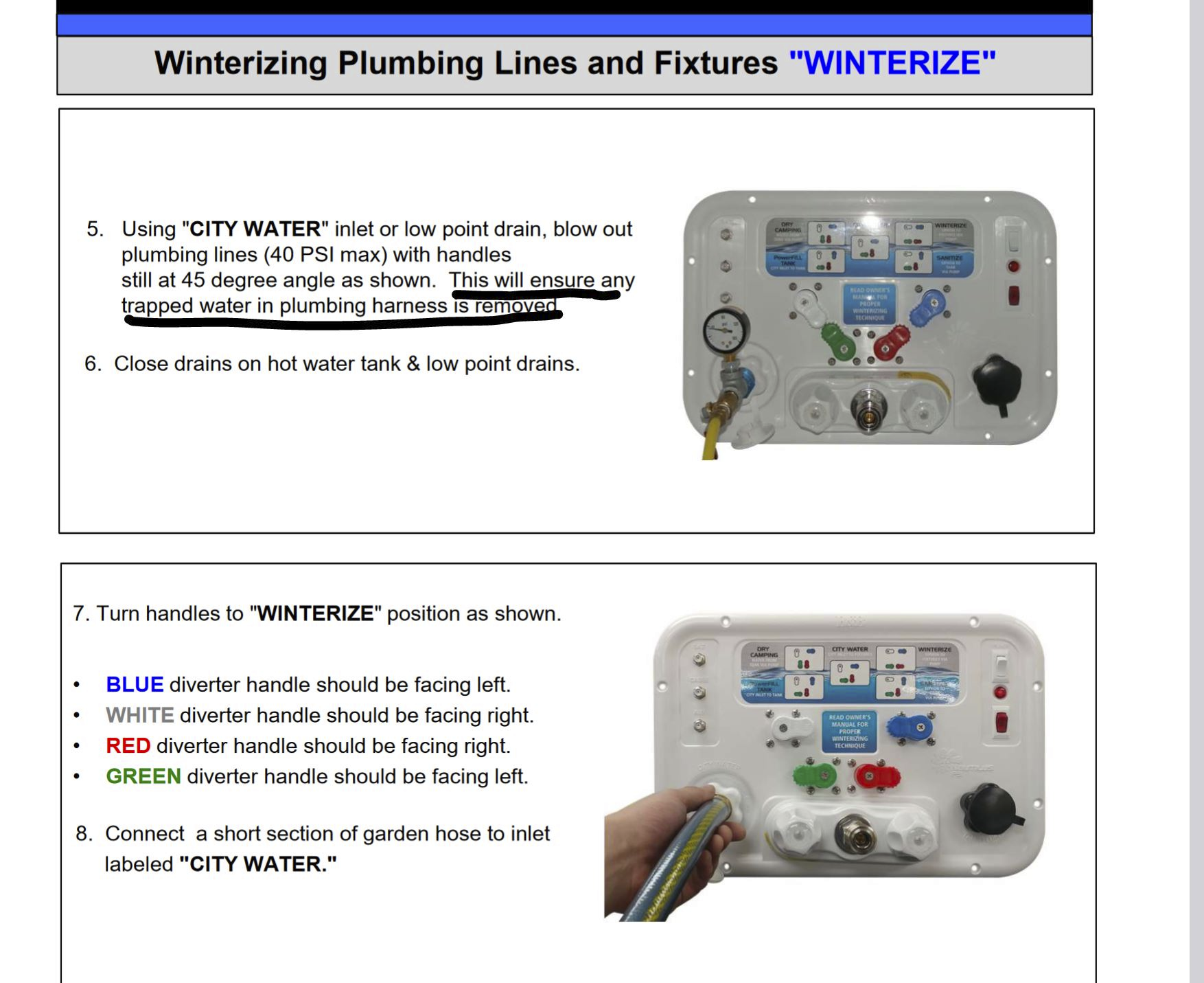

    @johnVT I completely forgot about that check valve. I think it's the first thing you should check, because it can get sticky. I have on occasion needed to reverse it even to fill from a pressured hose. I've also had luck just exercising the valve and giving it a squirt of silicone lube. And @MuttonChops is right about the pump, even if you choose not to fill all the lines, run that pump for a second or two to get the pink stuff in there. (I haven't found the need to open low point drains, but hey if it worked for you that's great ).
    There is constant confusion in the Nautilus trailers about the process of "blowing out" the trailer. In the step where the handles are at the 45 degree position, the only part of the trailer being blown out is the "Nautilus Harness", which apparently pushes any water in that area behind the Nautilus, and out through the low point drains. This setting at the "45 degree" position does NOT blow out the plumbing lines to the faucets. The Nautilus manual is very explicit about this. See the underlined note in the photo below.
    After the valves are set to the "Winterizing" position, or "horizontal", this is the setting that either RV antifreeze or compressed air actually goes to the faucets and fixtures.
