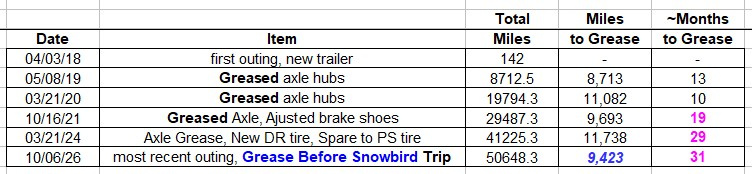

@crobo said:
a. . . Do you lube the bearings once a year?
b. . . And the brakes have lasted 50000 miles?
c. . . Have you every check the brake shoes?a Nope b Yes c Once
Reviewing my records it appears I've been servicing based on mileage only.
Have also only inspected brake shoes once. The 320S is light and I use 4 - 5.5 Brake Controller settings based on the water/cargo load in the trailer.Actual History:
