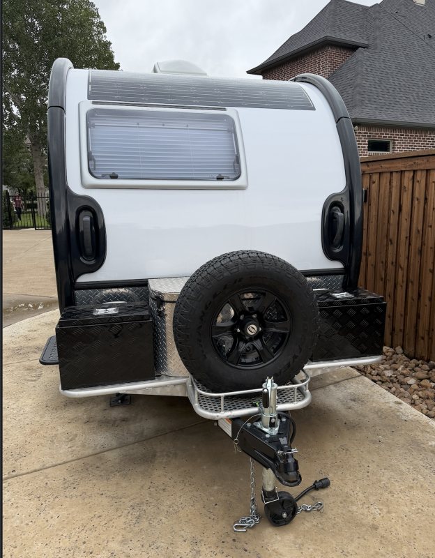

I recently moved my battery to a box 12 inches left of its previous location. No wiring was adjusted and everything is working as expected in the trailer. I hooked up my TV and my Redraw now flashes red. I disconnected everything and went through different sequences of actions taking when hooking up (Hook up 7 pin, start car, turn off battery disconnect) The only time it turns blue and seems to work as intended is when the TV is started and then the 7 pin is plugged and then the battery is switched on. This was never an issue prior to moving the battery. Did I inadvertently mess with something in my update? I will be transitioning to a lithium battery shortly but want to make sure I did not create a problem prior to doing so. Battery is now located in the black box on the right in the photo.

The brake controller is a Tow-pro Liberty. Per instructions I have found the solid blue is ready to use or normal. The flashing red may signify a grounding issue. I retightened the battery connections (these were the only ones I removed, cabling remained intact).
