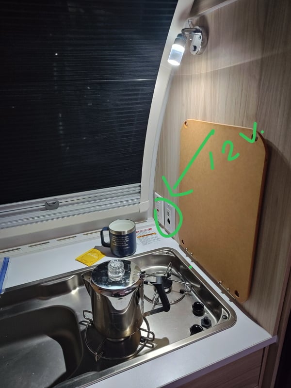

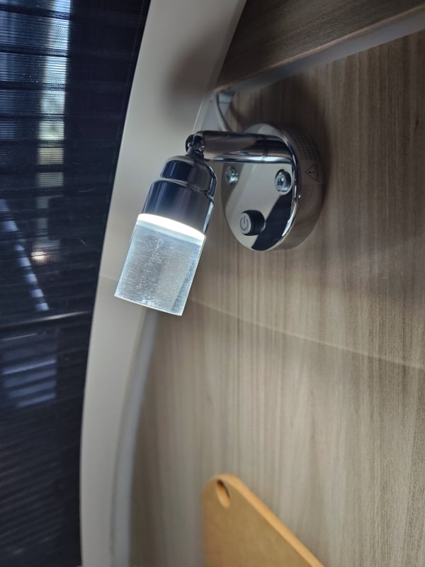

Generally the lighting in the 360 is pretty good, but we wanted a bit more task light at the stove and sink. The OEM lights can be found HERE. If you slide out the fridge you can access constant 12 volt power at the cigarette lighter jack to the right of the sink. Tap into that power and run it up to the back of the pantry and through the wall panel. It's a pretty nice upgrade.
