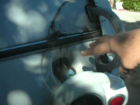

    I don't know if this YouTube video will help but but back in 2013 a guy named Rallylsetta made a lot of T@B related videos. In one he was talking about a problem he had with tail light leaks, i.e. he found water behind his tail lights in the little well that is there. Here is a link to the video it explains how he got behind the tail light and found the water and what he did about it. Possibly it may be of help to your situation.
    https://www.youtube.com/watch?v=NFQ12MDdEOM&index=16&list=PLzsC1ymNvWlHHG2YcYqqLR-X00hbX-oIj

    I have water in my license plate light as well, new T@B 400. Taking it back to the dealer would be a least a couple of days, all in the wrong direction. So owner fix time. Water comes in under the plastic diaper and then down the wires in to the lamp fixture. Had a huge glop of tub caulk on it but still water got in. I have pulled it away but not been able to get it drain. Now thinking of drilling a drain hole. Anyone else run into this?
    This trailer has never been driven through rain. But lots of rain has fallen on it. I think the water is wrapping around the outside, see the dirt? and then between the base and then in the wire holes. That's where the sealing should have been.
