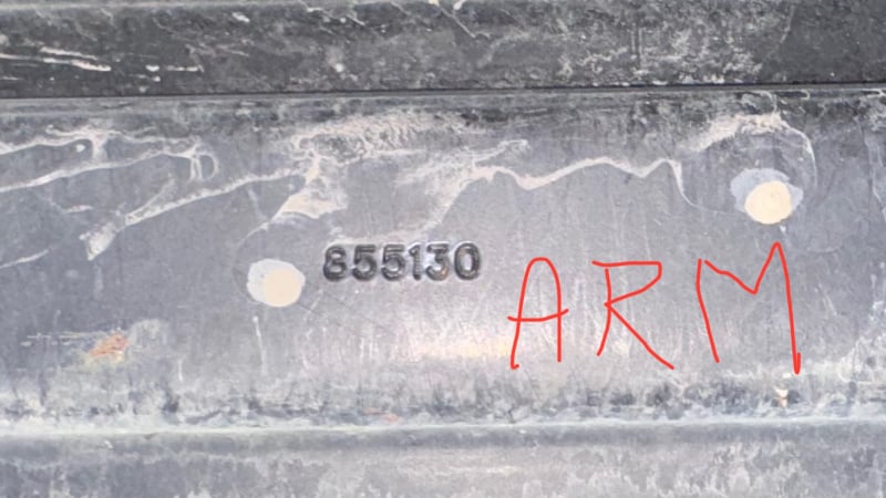

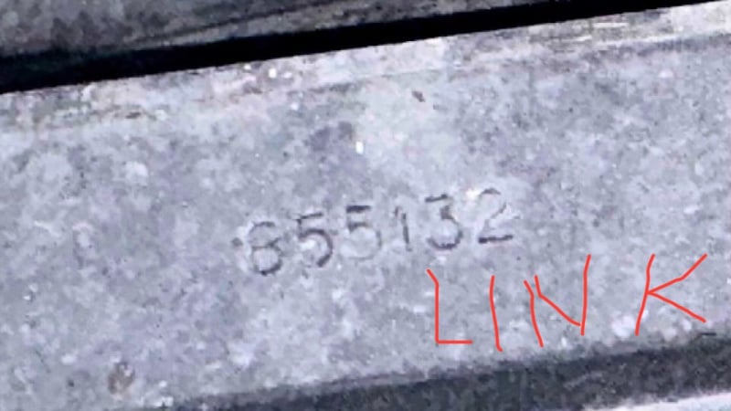

    Leaving this here, incase anyone needs it...
    The link and the arm each have identifying numbers stamped on them, here is the guide.
    https://balrvproducts.com/wp-content/uploads/downloads/tech/GDS.IDCJ_.001-REV-B-INDENTIFICATION-OF-A-C-JACK-BY-STAMPED-NUMBER.pdf
    Here's what the bent stabilizer on my 2024 320S BBC shows...so it is the 25" size.
