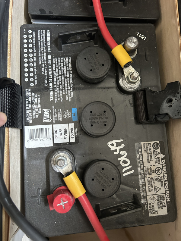

    So, I unplugged from power and used my voltmeter. Each battery has a charge of about 6.3 so that’s good. Tried to turn on fridge (3way) but wouldn’t work on battery. Might go leave the fan and some lights on to see how quickly they go down.
    Bad news: can’t find brand bc i
    cent lift them.
    Good news: they’re not original to the unit since there’s a 11/21 sticker on each!  See pics.
    FWIW battery on control showing 2/3 but I’d trust voltmeter instead.

    The battery is marked "8AGC2", which is a fairly standard 6V.  Only a few companies make these sorts of batteries, and the different brands just slap a label on them.
    What is interesting is the amp hour rating listed:  190 amp hours.  So, instead of the 225 amp hours we mentioned earlier, your "usable" amp hours are probably closer to 100-114 amp hours.  Which puts you very close to what your Weize 100 amp hour lithium can provide.

    Yes, the trailer has solar and the Victron! Interesting comment about the 190ah. No idea why the former owner installed that one. So, based on what you’re saying, I’d be good just installing my Weize instead of the existing 2 AGM batts?

    There could be a couple of reasons for the "2021" marked batteries in a 2020 trailer is the original batteries failed "out of the box" or....the original batteries were not handled properly and they needed to be replaced.  It was fairly common for new owners to destroy their first lead acid batteries, according to legend.  The learning curve on handling a new trailer and battery is a bit steep.  Improvements in monitoring and great group advice helped owners get through those sorts of problems in recent years.
    If the batteries needed to be replaced that soon, 2021 would have been mid-pandemic, and that could have been a factor on the smaller size.
    The difference in your Weize and your current AGMs is only about 20 amp hours.  If your AGM's are healthy, that change would be a bit of a wash.
