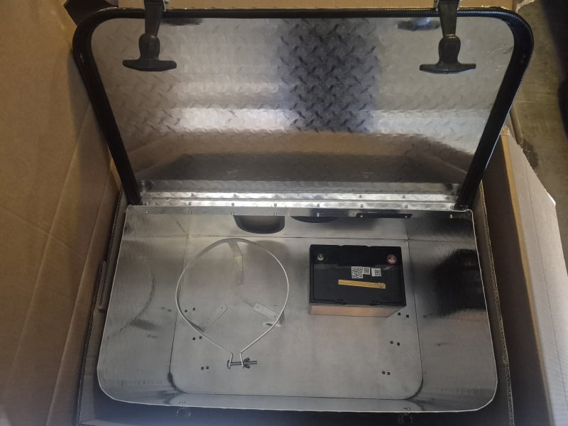

Here's a pic of the new tub. I will be adding a second identical battery to what you see in the pic and an inverter. TIA

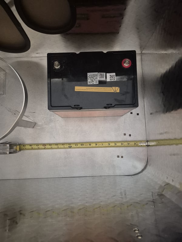

    Two individual Camco group 24 boxes would fit there. The lids are the widest parts and two boxes side by side would measure 13x18 inches.

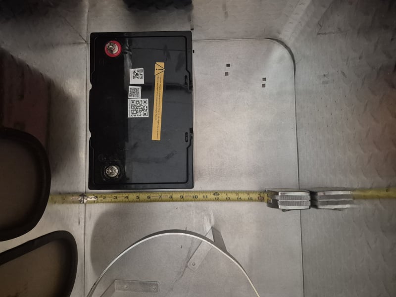

    @TourDeForth thank you. I'll have a look and compare that (for space) with this one I just found for 2 golf cart batteries, but I don't think the ones you mentioned will fit since 13 x 2 = 26" and I don't have 26" there. The largest I can do is probably about 16 x 18.

    I just upgraded to a dual battery set up and replaced my single Camco battery box with a Camco dual battery box but it houses the batteries end to end so it’s long and narrow. But, I took the measurements from my single Camco group 24 box that was in my Tab 320s utility box. It measures 9x13 inches at the widest points. So two side by side would take up a 13x18 inch space. (The boxes themselves are a lot smaller than the lids.)
