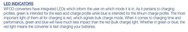

The WFCO "AD" model Power Centers are known to poorly detect Li-Ion Batteries and require the battery to be at near 0% SOC for the battery type detect. If you don't have the WFCO Owners manual get one from their web-site for your WFCO Model family.
The WFCO Power Center does have a Battery Charger feature/function. Read the operational section of the manual for a better overview of how the WFCO works.
For now, here is the Manual section on how to read the LEDs to get an idea of which operational state your Power Center is in . . .
The LEDs are not super easy to see. They are located at the bottom end of the 12VDC Fuse Panel and to the panel's left side, somewhat blocked by the metal face plate. (The LEDs are on the Convertor board not the fuse panel itself)

So many thanks for this as it indicates the WFCO is configured wrong. I have the Green light steady indicating lead-acid (I have 460Ah lithium originally BB 100Ah lithium).MuttonChops said:The WFCO "AD" model Power Centers are known to poorly detect Li-Ion Batteries and require the battery to be at near 0% SOC for the battery type detect. If you don't have the WFCO Owners manual get one from their web-site for your WFCO Model family.
The red light comes on blinking for maybe a minute then goes out. It will steadily move down the charging amps until it reaches 2-3 amps.
So reading up on it AD stands for AutoDetect which I take to mean it is supposed to figure out what type of battery and that there are no switches for me. That is unfortunate and means another trip to the dealer assuming I can convince him it is not Auto Dectecting0 -
