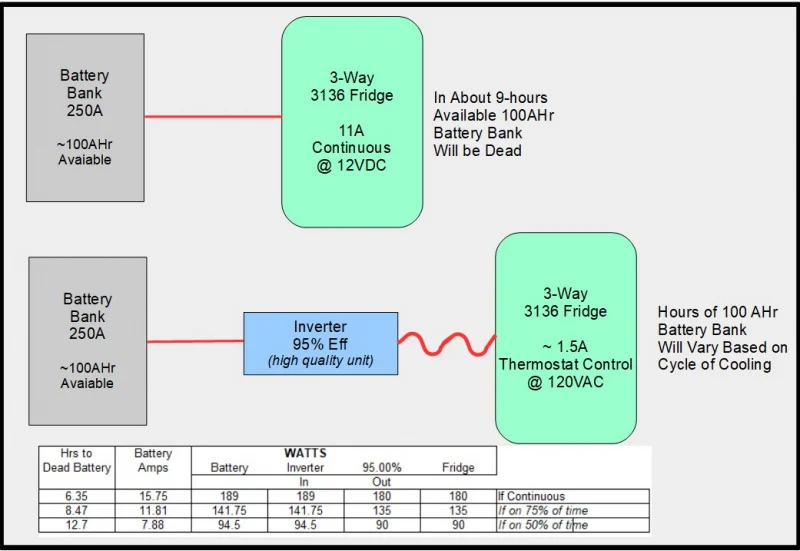

Your 3-way might be drawing 1.5 amps at 120V from the inverter, but to produce the 120V from 12V the inverter will consume about 15 amps from your battery when the fridge is cycling on. That doesn't include the inefficiencies from the conversion or that the inverter will be a steady draw on the battery whether the fridge is cycling on or not.ReenieG said:

@AnOldUR I believe the above chart did capture the efficiency of the Inverter and Duty Cycle of the Load for a typical (1st approximation) wet-cell battery. Of course the chart only has Fridge load and does use a very high quality inverter.
What is more worrisome is @pthomas745 observation that he did try using an inverter and thought the Fridge was On most of the time . . . so there was little benefit from having a thermostat control.

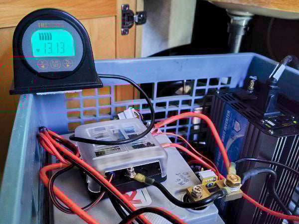

I worked on this a day ago, and...got sidetracked with "stuff". I am still not sure if the 3 way fridge..running on electric...has any sort of duty cycle. Here is a photo of the setup: a 50 amp hour lithium battery, and a 600 watt inverter. This is one of the Will Prowse "Milk Crate" alternatives to the spendy "solar generators". It was a nice project for me, just my skill level. Needs a bit more work on the "wire dressing". I use it for my portable 12V fridge when I'm on the road. Hard to see ( I will edit this photo later)....edit, picture fixed so you can actually see the inverter!). The fridge is plugged in to the inverter over on the right side of the photo. My Aili battery monitor is showing the amp draw at 13.13, which seems to match the 11-13 amps the fridges are always mentioned as using, with probably about 1 amp for the efficiency of the inverter.
I'll run this for a couple of hours tonight again, but I really think I should start earlier in the day, with a partially cooled down fridge. With the test from a day ago, that 13 amp draw was constant, but the fridge was cooling from around 68 inside the fridge, and I only kept going until I ran out of time, and the fridge was down to around 53 degrees. So...the fridge does work this way, and with a larger battery and a decent solar input, it could be doable.Does a three way fridge, which needs to heat ammonia to produce the cooling effect, even have a "duty cycle"?2017 Outback

So, your inverter is drawing 13.13 amps running the fridge at 120V. Have you checked the amperage that just your fridge draws when plugged into a 120V shore outlet? In previous posts 1.5 amps has been quoted. I'm curious what your actual number is.
Also, how many amps does yours draw when running directly on 12V? I've seen 11 amps, but again, a direct comparison would help to eliminate other variables.Stockton, New Jersey

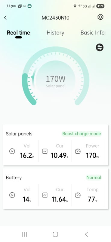

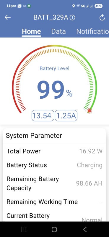

So to throw a couple of wrenches in this discussion, about amperage and draining batteries and how long they will last, my solar panels were charging my batteries while I was running my fridge on 12v while driving. Of course, since I was driving, my car was also charging the battery through the inverter. At times, the solar was charging the battery more than discharging. I'd have to shut off the converter breaker next time to see how much charge I'd get just from solar alone.So, with all things (close to)even on amp draw on ac or dc, and as it definitely appears the fridge cools much better on ac, the ac still might be a better option with an inverter.
