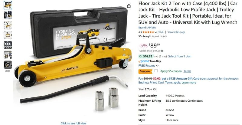

-Jack: I checked the scissor jack from my truck. It seemed fine and fit easily under the lifting points on the T@B. What I didn't think about was that the T@B would be a few inches lower with a flat tire. My scissor jack would not fit under the T@B when the tire was flat! Luckily, I wasn't far from home so my Son-in-Law brought me his low-profile floor jack which worked well. With the tire flat, I had about 4" between the concrete and the lifting point. I ended up purchasing a small floor jack from e-bay that is about 3 1/2" in its lowest position. It's a little cumbersome, but it works great and comes with a nice carrying case.
Lug Wrench: The lug wrench from my truck did not fit the nuts on the camper. I just went to Harbor Freight and bought a cheap, 4-way lug wrench. NOTE: The sockets that come with the floor jack pictured above do not fit either!.
