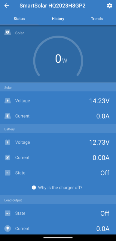

In desperation, I cleaned the panel to determine the impact of dirt/grime, but it only increased by .5-.75V to 14.23V, as shown in the screenshot below.

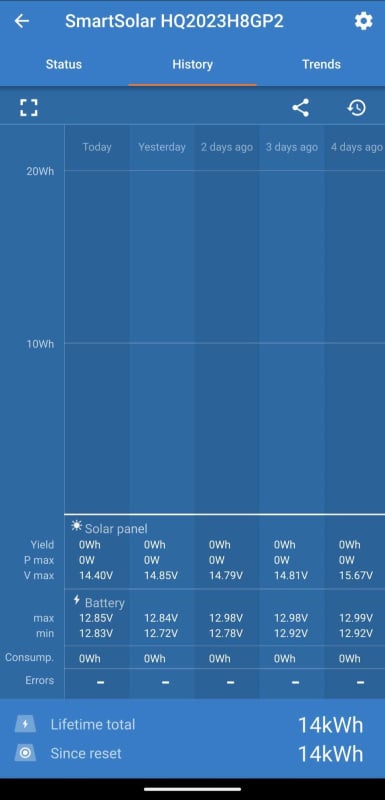

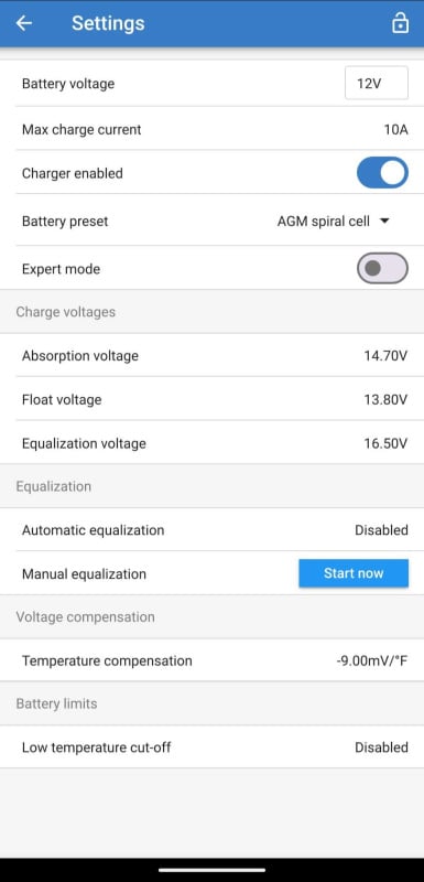

Show us your history page and battery settings pages. If the settings are still set for lead acid charging, the Victron is seeing a fully charged lead acid battery. "13.6" is also the basic voltage you will see when a lead acid battery is being charged by any source.Shw us the History and Settings pages.

Thanks! See below.
I selected the AGM Spiral cell preset when installing. The history shows the past 4 days, but voltage range is comparable (with no charge) over the past 3 weeks since installing.

I'm really sorry, I saw the "Weize" battery, but my brain skipped over the "AGM" part!Your battery voltages appear to be completely charged for a lead acid battery. Has the trailer been sitting with the switch off? Or on shore power? Every one of the battery numbers (status, min/max, etc) show a completely charged battery. The "charging is off" on the app because the battery does not need charging, according to the history.What happens with the trailer running something like the fan or the fridge? Letting it run for a while, and see if the solar kicks in?

Yes, the battery is mostly charged. I put it on a charger before installing, and we've only camped with shore power since I'm not confident in the solar. That makes sense that it won't charge a full battery - I wasn't thinking about that angle, thank you.
I accidentally left the battery disconnect switch on a few days ago, which may be responsible for the drop from '2 days ago' to 'yesterday' in the screenshot. All equipment was powered off, so that would have been all due to parasitic draw. I could try leaving something on to draw it down further to see if solar would kick in.
That said, my logic says that may not make a difference. If I remember correctly, the minimum battery voltage is ~12.2 before it needs to be recharged. If the controller requires >5V greater, the solar panel would need to be providing at least 17.2V. If the panel itself (tested at quick-connects on the roof) isn't putting out more than 14.4-15.6 under optimal conditions, it doesn't seem like it will ever reach the voltage needed.
Am I missing anything in my logic or assumptions?

danwrona said:. If I remember correctly, the minimum battery voltage is ~12.2 before it needs to be recharged. If the controller requires >5V greater, the solar panel would need to be providing at least 17.2V. If the panel itself (tested at quick-connects on the roof) isn't putting out more than 14.4-15.6 under optimal conditions, it doesn't seem like it will ever reach the voltage needed.
Am I missing anything in my logic or assumptions?Nope; the panel is the problem. It should be generating a higher voltage in the sun. That’s independent of the battery’s state of charge. Perhaps it was damaged when it was re-secured to the roof.Charles & Judy, Santa Cruz, CA
