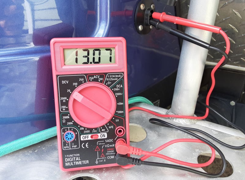

Hello all,
Many posts on this forum seem to suggest that the Nautilus port can be used to power something in addition to being an input for a solar panel/charge controller.
I have a 2025 Tab320S and that doesn't seem to be the case. The port appears unpowered or is floating at about 14 mV. The black wire seems to head to the ground bus bar under the driver side bench. The red wire is heading back into the ALDE area. I have not traced it fully yet but is may be heading towards the batteries. Does anybody know what the deal is?
My goal is to power my Starlink mobile off this port if possible so I don't have to run a wire through window or the door.
Thanks in advance.

EDIT - False alarm. I think I just didn't have my meter probes in the port deep enough. It shows 13 volts. The polarity is reversed when compared to my port plug that I got from Amazon. The plug has the top female part black and the bottom male part red. The voltage is actually the opposite of that. Not sure who screwed up...2025 Tab320S pulled by Ford Maverick1

Hello all, I just wanted to report that the Starlink Mini works fine running of the 12 volt cigarette lighter using the adapter I purchased from StarLink. I also made an adapter that converted from the SAE port in the Nautilus compartment to a female cigarette lighter and that worked fine as well. I definitely had to reverse the polarity on that.2025 Tab320S pulled by Ford Maverick1
