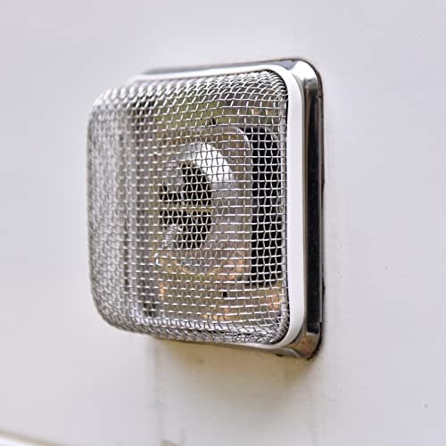

What I DID discover when I sat down to learn this procedure was that I had a swarm of wasps that had taken residence in the Aldi vent pipe. They shot out of that pipe like little rockets, fiercely pelting my face repeatedly. When I figured out what was happening, I stood up and ran. I tried to resist the temptation to swat at them--figuring that would only anger them more. I ran around the house and ended up with one sting in my ear. It hurt in such a sensitive spot, but I'm not allergic, so I just spent the rest of the afternoon with some ice on my ear.
Two days later I got back to it and was able to slurp up a water jug.T@B 360 Black Canyon, 2021 Jeep Grand Cherokee V6, Maryland
(previous 2018, T@B 320 Outback) -
RV vent screens are your friend in this regard.
