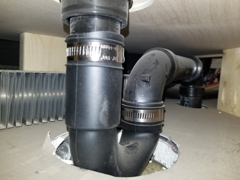

    rh5555 got me thinking and maybe found a fix.  The orange square would not slide over the drain as the drain stood up higher than the shower pan floor.  Thus even if you squeegee water over to drain it quickly goes back to the low corners of pan.   Took pictures and you can also see the blocking to support weight similar to rh5555.  Problem is the shower pan on the corner near back of trailer doesn't have blocking which is the reason for the low spot on the endge and I don't think I can put it there due to how pan is made and attached.  Going back to the drain I was able to use door shims and wedge in between the black flange lips and the bottom of the wood floor near the shower pan bottom.  This pulled the shower pan down to the wood floor and now creates a decent gap between the drain and the level height of the shower pan.  I believe this will now drain much better.  Will try out during next shower and let you know.
    Also while down there took a shot of the new Transcore floor that is visible due to the cut to allow the p trap.  The p trap though is rubbing on a sharp corner of the floor so likely I need to fix that or it might rub a hole in the flexible pipe.  Seems the hole placement didn't align with the p trap.
    (Took another pick with a yellow level to get a better view of the gap that was previously negative.)

    The rubber P-trap was also pressed into the edge of the floor cutout creating a slight indention. I discovered it one month past my one year warranty and NuCamp wouldn't pay to have it fixed. I had to pay the dealer to widen the floor to create a gap.
