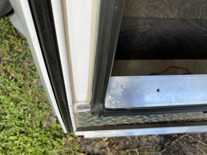

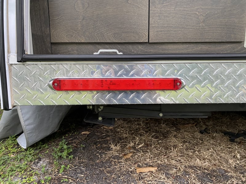

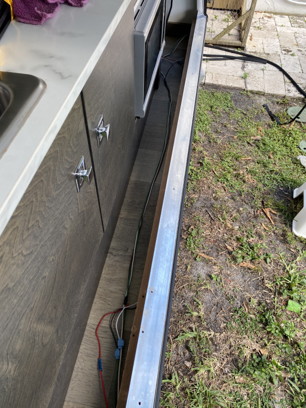

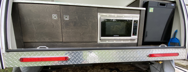

Hello. I have a 2021 tab 320 CS-S and I have to replace the 15 inch tail light because both have water inside and the one in the left has some missing LED. I bought the lights in nucamp store. The problem is that I don’t find the access to the junction box to replace them. When I separate the light from the metal, there is a tiny hole where the cable came out. Everything looks seals. Does anyone know how to do it? Thanks.

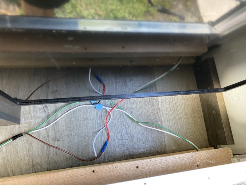

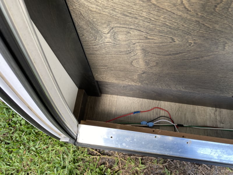

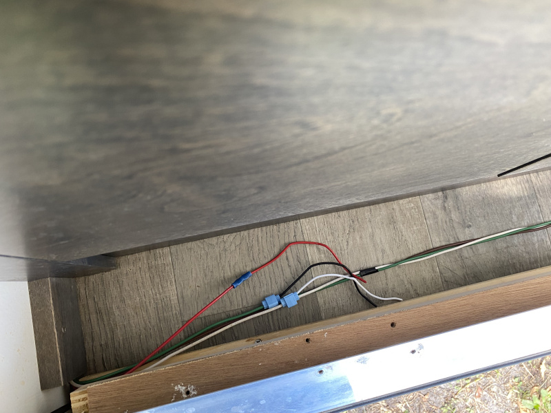

The aluminum bar across the top of the opening unscrews from the top. Save the washers under the lock bars. A piece of wood trim will lift out. Behind the wood is the wiring and associated connectors.
By the way, I figured out the water is from condensation on the door frame during the winter. It runs down to the wiring... ; )2018 320CS-S
"Just Enough"2 -
Thanks Mickerly. I will do tomorrow. I was very worry because I go camping next month. . About the water inside the tail light, I don’t know because the light looks completely seal but maybe your right. Thanks again for your feedback.0

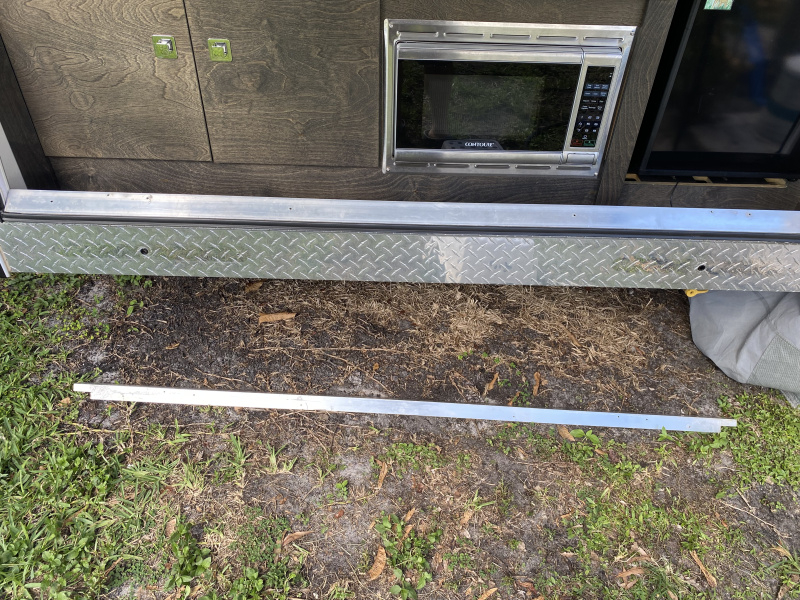

On some CS builds the aluminum bar is sealed down with Geoseal. It is very difficult to separate from the frame because of this and requires a thin blade between the parts. A power "multitool" with a thin blade works well.Mickerly said:The aluminum bar across the top of the opening unscrews from the top. Save the washers under the lock bars. A piece of wood trim will lift out. Behind the wood is the wiring and associated connectors.
2 -
Fortunately my '18 wasn't glued down ; )2018 320CS-S
"Just Enough"0 -
I was finally able to replace the taillights following the instructions you gave me. The aluminum bar covering the top had silicone on it, but I was able to carefully peel it off the other aluminum bar underneath using a thin screwdriver, and the rest was easy. Thanks for the help.
No problem. I did mine last fall. Condensation in the hatch runs down to the corners and flows over to the tail lights. Wiping down the hatch with a towel a couple times per day while winter camping will prevent further damage.2018 320CS-S
