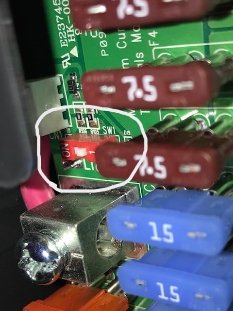

Hello! I will be swapping out current 6V lead acid battery for a LFP 100 AH battery in my 2022 tab 320S boondock. To do so, I have to disconnect the "inline fuse on the positive solar lead" where exactly is that located? Also, I am utterly confused as to where the fuse panel is in my 2022 Tab 320S boondock. I reached out to NuCamp to confirm my Tab 320 has the WFCO converter that automatically detects a Lithium battery. IS the WFCO converter located in the front tub to the left side of the battery disconnect? OR, is it located under the drivers side dinette seat and if so is there a removable panel somewhere? HOW to I get to this? Why is this so confusing? I am including this picture that NuCamp sent me. Where is this? Thank you in advance!
The Power Center that contains the breakers and fuses is behind the dark brown panel on the front of the driver side bench. Just press the panel and it pops open. You are lucky as it looks like you have the lithium compatible converter with a switch to change it to lithium.Sharon / 2017 T@B CSS / 2015 Toyota Sienna Minivan / Westlake, Ohio0
