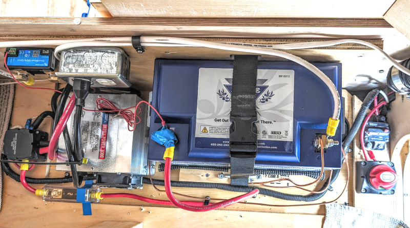

  • jimcennamejimcenname Member Posts: 330
    FYI: One 100ah Battleborne with a new Power Dynamics 45 amp charger right next to the Lithium battery to reduce voltage drop from WFCO at the front of the 2019 T@B400. I disconnected the non-lithium charger in the old WFCO and continue to use the old WFCO for power distribution.
