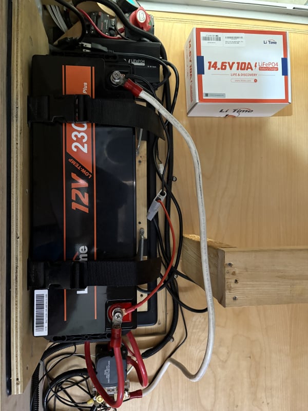

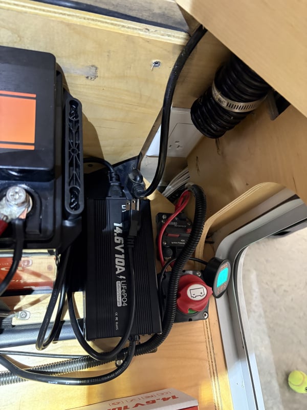

I also just did this swap with the LITime 230 Amp hour battery but I used a 10 amp LiTime Charger. In my 2019 with the smaller frig there is a 20 amp plug used for the frig right inside the cargo door and the space was just right for the 10 amp charger. I too was concerned about multiple inputs confusing the battery so I disconnect the battery when on shore power and plug the little charger into the plug and no issues. I got a small splitter for the plug so I can keep the frig plugged in and then take the 10 amp charger plug in and out easily. As it is a 20 amp shore power circuit I can run the charger and the frig on shore power (but not the microwave, which is also on that circuit)

@donmontalvo I just got back from a 4 nite trip where we had power at the state park. Going there with the battery on and the frig running our TV (no DC to DC charger installed) just provided a few amps (like a trickle charge) when driving so we lost about 5% of the battery over the drive day. Then I had plenty of time so I just turned on shore power and disconnected the battery and plugged in the 10 am charger using the plug I described above. I could easily have used the campsite 20 amp plug and an extension cord. No difference. So I was approximately 17 amp hours from 100% and the 10 Amp charger ran for about 1 hour 45 minutes. I did notice that the charging voltage was similar to the WFCO except for the last few minutes when the voltage began to steadily rise from 13.6 or so up to 14.6 and then it cut off. I don't see a need to let the WFCO charge the new battery at all unless this charger fails while travelling.

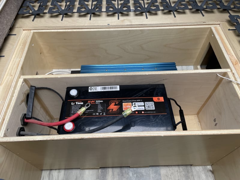

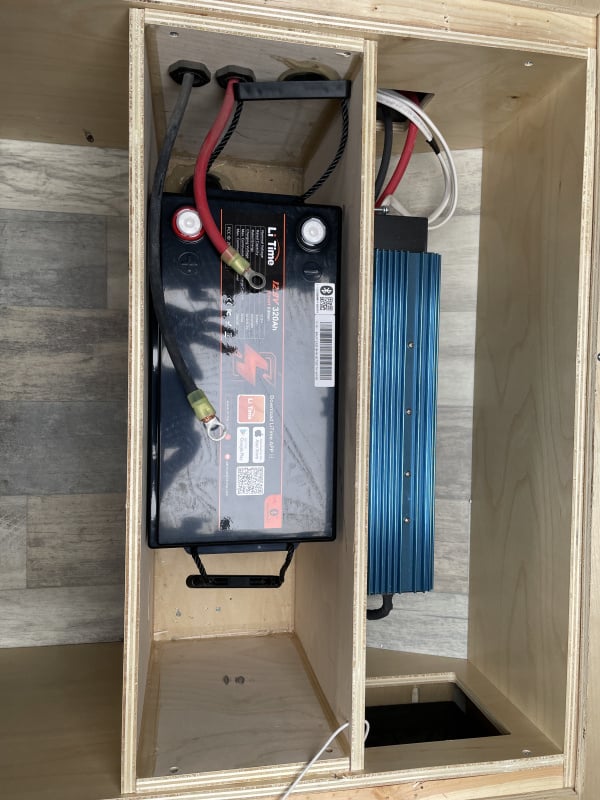

The new LiTime 320ah Mini fits perfectly in the original space of my 2022 Tab 400 Boondock. Unfortunately, we purchased it used with a crappy LA battery. Adding a new Victron Lithium charger, a 2nd Victron solar controller for the external solar port, and a Victron Smart Shunt. Hoping this gives us the capacity to Boondock for extended periods.
