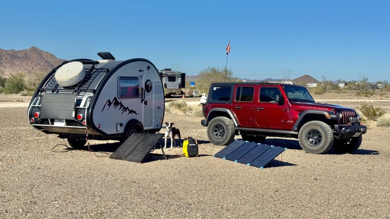

I recently also bought a Renogy 220W folding solar panel. I made sure it did not come with a PWM controller. Lucky that it didn't. My JLUR has a Renogy DCC30S (DC to DC with MPPT) so it's 12V 100Ah LiFePO4 is charged whether I'm camping or driving.FWIW I've never been a fan of PWM controllers.
