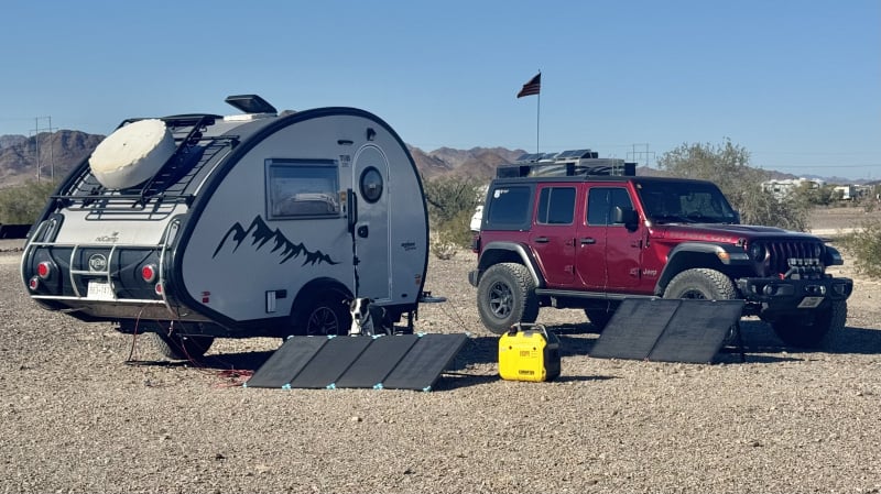

I have a Rich Solar MEGA 200W suitcase solar panel. I didn't expect it to come with a PWM controller. I immediately took the PWM controller offline, since I have a Victron 100|30 connected to the SAE port in the Nautilus compartment of my T@B 320. My 12V 2x100Ah LiFePO4 parallel array quickly charges up, whereas the PWM was iffy.Good video on PWM vs MPPT:https://www.youtube.com/watch?v=fTvNqxLCkJc
I recently also bought a Renogy 220W folding solar panel. I made sure it did not come with a PWM controller. Lucky that it didn't. My JLUR has a Renogy DCC30S (DC to DC with MPPT) so it's 12V 100Ah LiFePO4 is charged whether I'm camping or driving.FWIW I've never been a fan of PWM controllers.

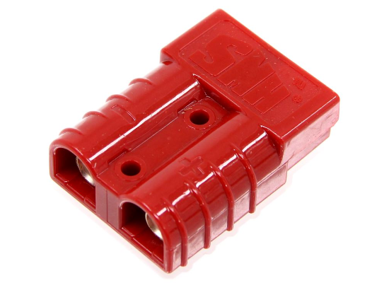

Another option that I used is the quick disconnect connector below. I connect it thru the open side access compartment by the battery. It has good wire gauge capability compared to the SAE connectors.
Rich2019 T@b 400
I agree with @Horigan. For this purpose, SAE connections are not great. I recently switched out our SAE solar connections for Anderson.
