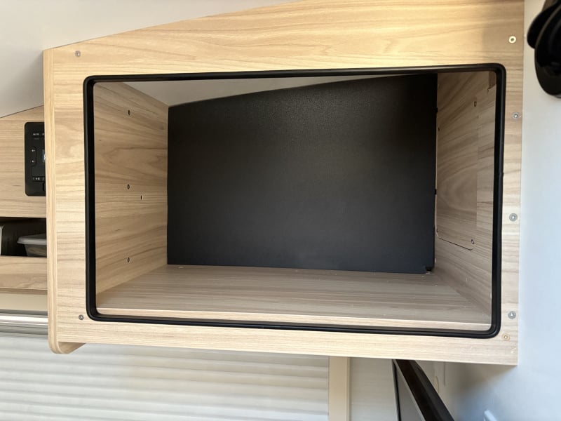

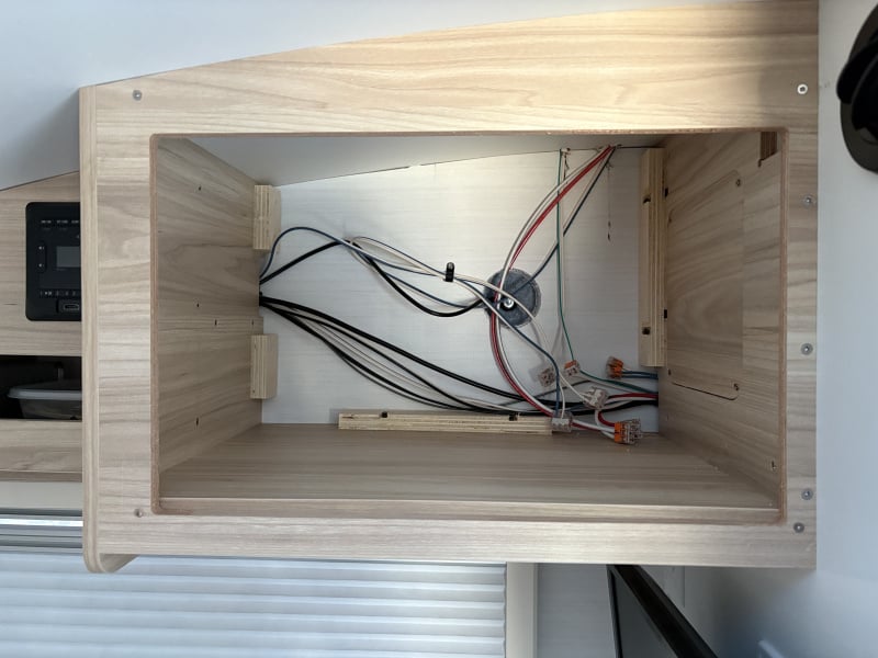

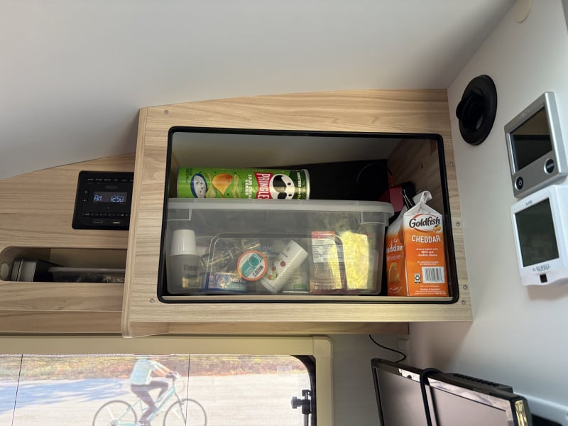

    I rarely use the microwave at home and don’t see any need for it in the Tab (320). I took mine out to use the space as a pantry. No need for the aftermarket/replacement cabinet door. Just install a cargo net. You can also get a rubberized self adhesive trim for the unfinished opening. I used some black ABS sheeting to cover the back part where the wires are. I will try to post some pics here…

    If you decide to remove yours you will most likely have to pop out the AC vent and then remove the black plastic ring that holds the vent in. Once the microwave is out then you can reinstall the ring and pop the vent louvres back in. Also search the forums and you’ll find a bunch of tips on this subject and some on making custom cargo nets (which I have yet to make, but did attempt once and wished I searched here first since I failed miserably, lol).
