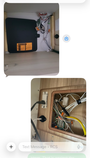

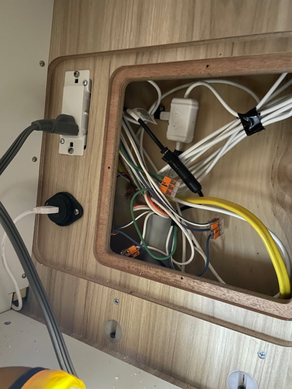

    Hi,
     I don't have a picture of the antenna in mine (still looking) but here is a picture of the hidden booster/amplifier (the Winegard small white box..i believe that is it..or maybe it's a splitter, but there is Winegard label  on the it ) in a 360. It's also located in a hidden cubby behind the microwave.   It is USB powered. Another 360 owner showed me a picture of a flat antenna his came with behind the microwave (second picture) , but mine is not located there.  I tried to follow the cables, ran out of arm length and view.    I would think there is an antenna somewhere, since this other device is there.  I emailed Nucamp, and just like the 400.   Nucamp said it was put in some 360 builds, but not all.

    pthomas745 Administrator, Moderator Posts: 4,532
    @Yoshi_TAB thank you very much.
