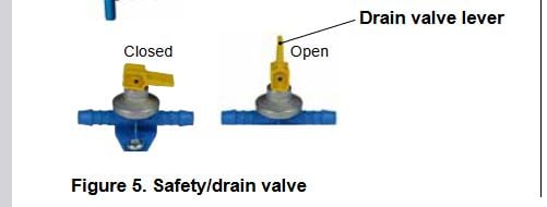

Yes, you can use the Alde with no water in the trailer plumbing. It can make heat just fine.To prove to yourself the Alde is empty, all you have to do is open the "Famous Yellow Flapper Valve" in the Alde compartment. If the trailer was winterized properly, with the Nautilus valves in the proper position...nothing should come out.Which "Nautilus" version do you have? The "2.5" version with the two "handles?"Or the 3.0 version with the 4 handles?Depending on who you are buying the trailer from, they may have zero zip nada idea of what the Alde is and how it works. That little test with the "Famous Yellow Flapper Valve", which is the Alde hot water tank drain, will tell you quite a lot. The Yellow Valve looks like the ones in the photo below. In your 320, you will only have one of these Yellow Valves. With the valves pointing up like these, the valve is open, which would indicate the Alde tank would have been drained. When the valve is "horizonal", it is closed.Take pictures and ask questions if you need to! And, welcome to the Forums!
From the Alde Manual.
