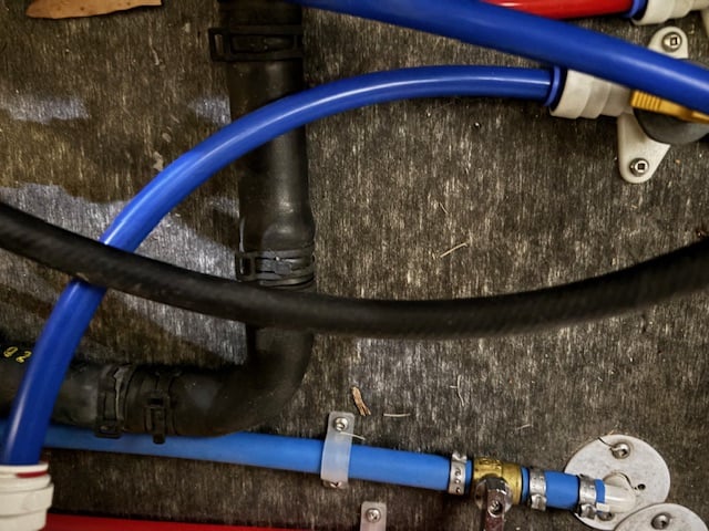

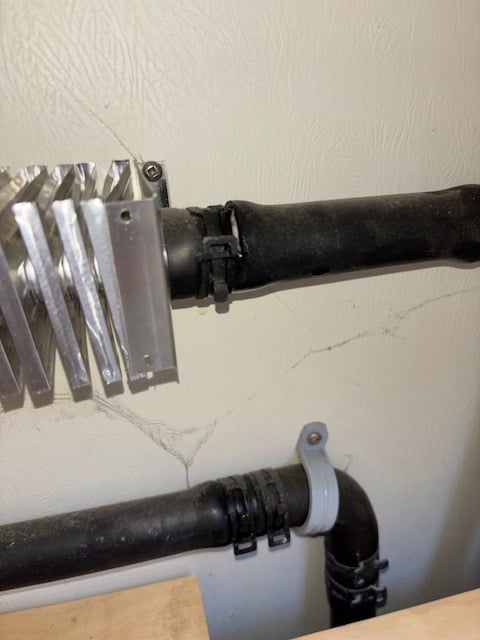

Found the leak behind the bench seat on drivers side. Corrosion got bad enough to crack the hose.
Also note that there is a bulge starting at the connector just under the leak.

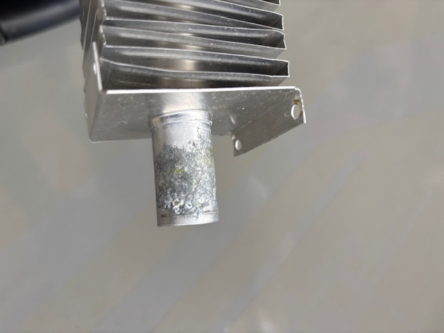

Removed the convector:
This is the side of the convector where the leak was after cleaning off the loose stuff. There is one pinhole, so you can see corrosion starting on the inside. The other side of the convector showed some discoloration but no "loose stuff" . This made me start looking at the rest of the connections of the tubing. Already removed the convector under the bed which was not quite as bad but close.

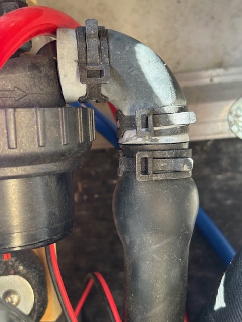

Two other places that concern me are the connector where the pump is prior th the Alde Flow and another short section near the Alde where I believe the check valve is.
Most of the other connections seem to be okay, but will definitely be inspecting them on a regular basis in the future.

Good detective work! There are tons of posts about "corrosion of the Alde convectors", with various solutions. Basically, the stub ends or aluminum parts are cleaned off and "sealed" in some way. And then replaced with the clamps in the proper place at the "end" of the stubs, and not in a place that allows the glycol to be trapped under the hose. The solution by the owner in the thread you linked to is one of several that use the same basic approach. Other owners have used things like shrink wrap, etc. This is the "Corrosion of the Alde Convectors" thread. If you page backward through it, you will see what other owners have done to mitigate the damage. Link goes to the last page, just skip back in time and see the photos of what owners did. Lots of discussion about the glycol, etc.This Mark Turney video goes in great depth to explain what is happening with the corrosion, and goes a long way to define exactly what the glycol is, what the anticorrosion substances are, and what they do. In the second segment of the series, he shows how they should be cleaned, coated with "Magic Paint" and clamped properly.

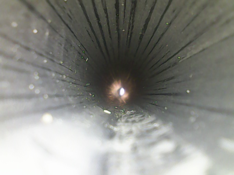

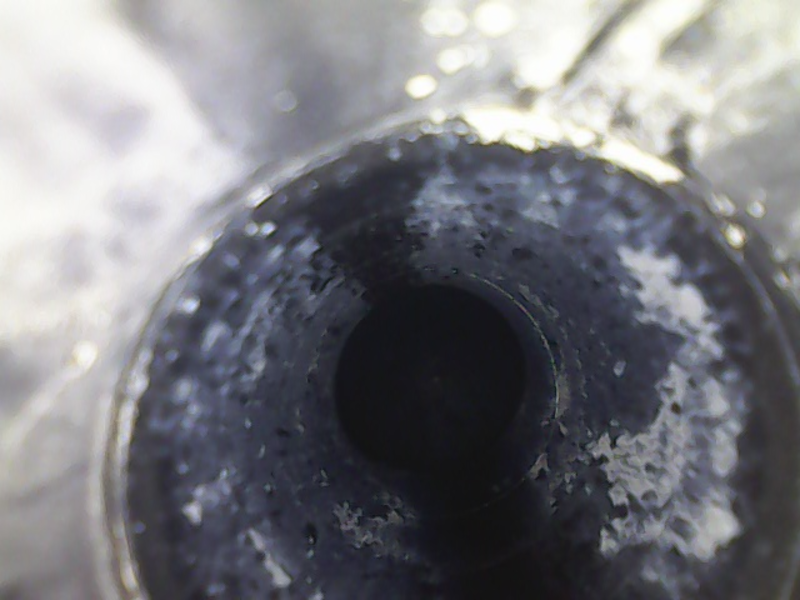

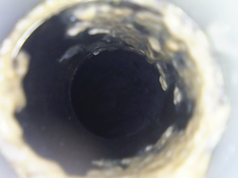

@madhatter1620, there is a lot of great reference material you have to sift through. Owning a TAB 320 for 6 years and performing 3 ALDE system flushes, it is not only what you can easily see but what is not easily visible that may lead to issues later.Latest flush revealed obvious corrosion on the convector tube ends, decided to look deep inside the convectors and discovered what looks like the beginning of corrosion based on my previous observations. To my untrained eye, the top and sides of the tube look good, bottom of the tube where the ALDE sits showing signs of pitting. Replaced all convectors.
Didn’t want to replace more parts than necessary so decided to look at the reservoir connections. Out flow connection from reservoir.
Inflow connection to reservoir.
Decided to replace reservoir.Pictures were taken using an Endoscope camera attached to iPhone, quality of pictures does suffer a little.Good luck with your ALDE fix.2020 TAB 320 U

Thanks so much to all for your inputs! Not prepared to take the entire system apart at this point; want to be able to do some camping. Have removed the reservoir and all the tubing from it to the convector under the bed. Also, what I can reach at the convector behind the bench seat where the leak was. Found that the connectors that were parallel to the floor were much worse than the ones that were vertical. The connectors were corroding from the outside but the valves were corroding from the inside as well. I plan to fix up those areas and then see how it works before working on the rest of the system. Contacted Truma service (877-860-9814) for parts. At first they said I had to go through a distributer but then said some things they could ship direct. Have 25 of the plastic connecters ($1.55 each) and 2 "non-return valves" ($9.11 each) on their way. They only had the valve in the 90mm length.
Mark Turney's videos were fantastic, especially for understanding what is happening. Not prepared to buy a quart of the miracle paint ($55) since I will probably be taking the rest of the system apart winter after next, baring another issue prior to that. Plan to use several coats Rust-Oleum self etching primer ($10) for now on the convector ends and the valves, and doubling up on the clamps there. The rest of the connectors will be plastic. Once it is all together again, I will flush with distilled water prior to refilling with the yellow Century glycol.
