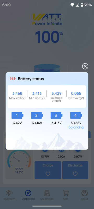

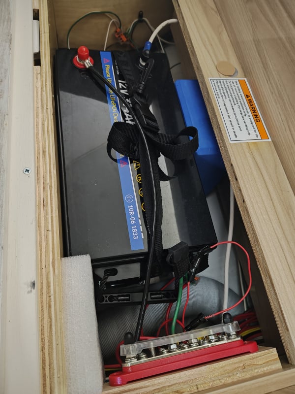

I decided on the WattCycle 314 mini/BT. I didn't think I needed the Bluetooth but the standard variety was not available. (Now that I have it the Bluetooth is kind of a nice backup to the Victron Smartshunt.) It's slightly deeper than the battleborn so I had to modify the retainer strip that held the 360s OEM battery in place, and move the strap tie down points a little wider to accommodate longer length. It's also slightly taller but it does just fit. It took about 15 hours to charge it up to full with the wfco 8735 charger. SoC reset to 100%. So far so good. We leave Monday for a shady no power site! For me the BattleBorn was great, just not big enough, but I'm optimistic about the WattCycle as well.1
The WattCycle App, via Bluetooth.
