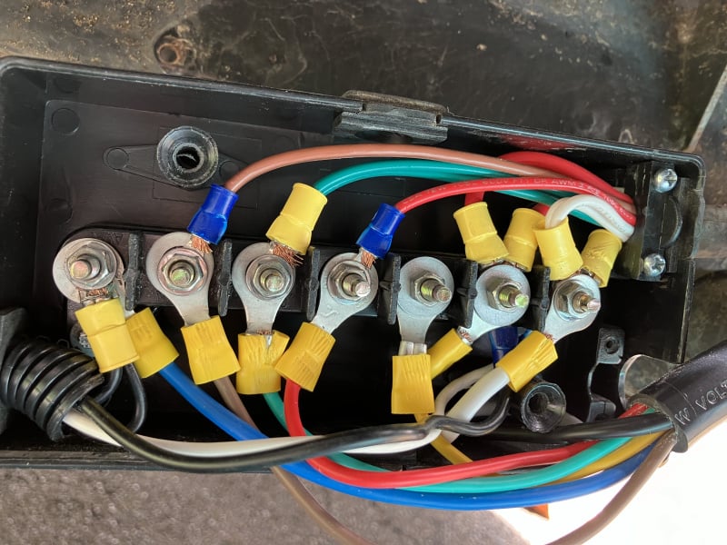

I have a 2015 360s Boonedock. My plug popped out while driving and trashed it. I bought a new harness, and I thought I had wired it the same way: blue, brown, green, red, yellow, black and then white. I have a Bluetooth brake controller.

@michaelroyy, your wiring looks identical to my 2019 junction box wiring, except that mine has a blue wire connected between the trailer emergency breakaway switch and terminal #1 in the junction box. Yours has two black wires that appear to be joined together with a single terminal lug. I'm not clear as to what those wires are, unless one is from the trailer brakes, and the other is from the breakaway switch.
The other connection that I cannot clearly see is the black wire exiting the wire loom on the left, which appears to be connected to terminal #6 (but, potentially, to #7) - - I have a red wire connected between the breakaway switch and terminal #6, so maybe yours is just black rather than red?? (I agree with the comment by @MuttonChops re confirming the color codes, because that may what the issue is).
Maybe double-check each of the connections I have referenced.
Terminal #2 (brown wire) is for the right turn/stop lights - - it appears to be wired correctly.
Double-check your ground wire connections as well. Often times, that is the simple solution.
If it is of any assistance, I have included a closeup of the drawing posted by @MuttonChops so you can see the wire colors clearly, as well as a photo my junction box connections. Good luck!!

Thank you both for responding and the details. I will probably be at it today. Probably start out with my meter and work from there on the diagram & pictures. To be continued...2015 Boondock0
