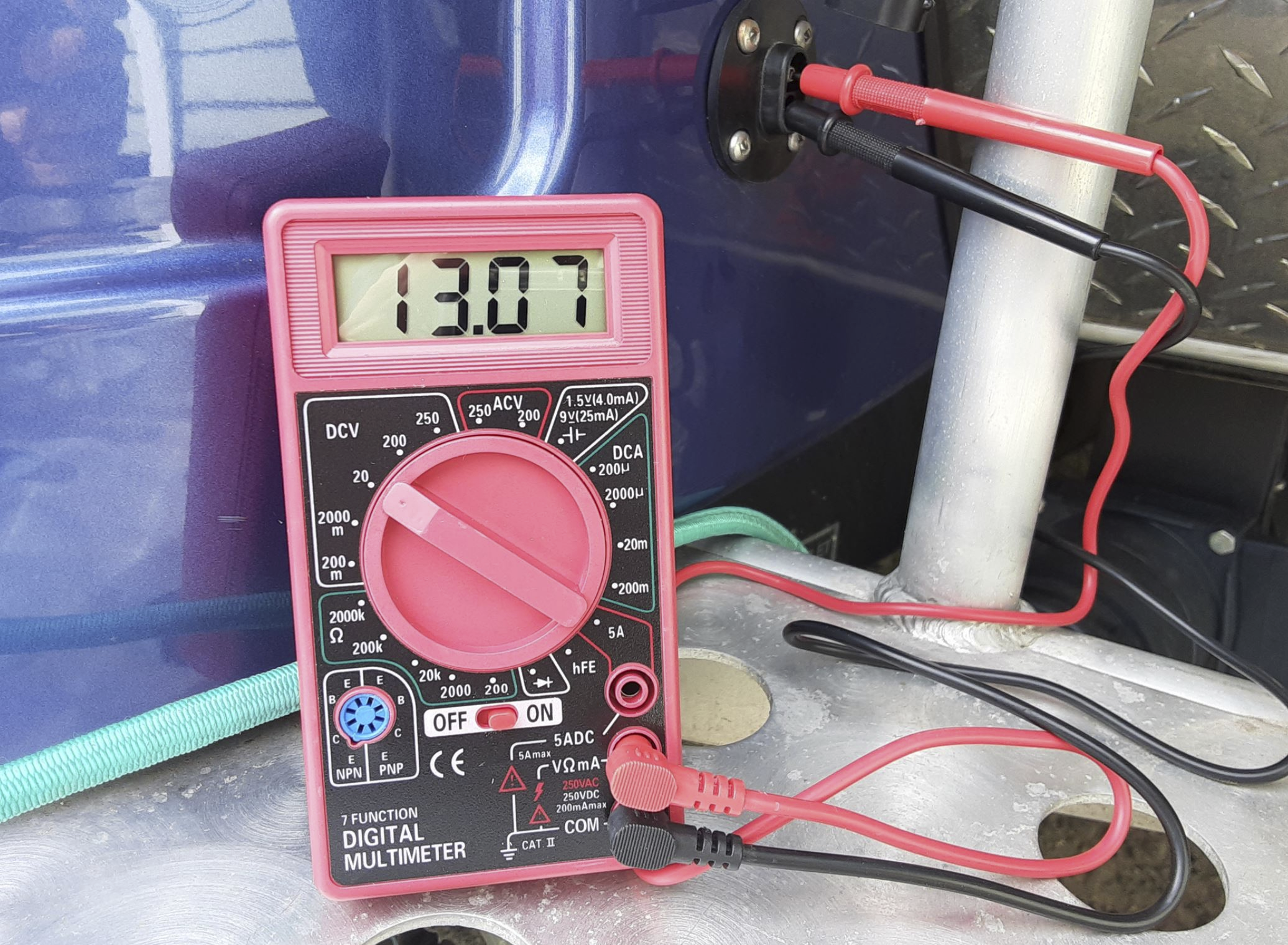

You need a separate solar controller to connect a panel to the SAE port on the trailer. A properly wired cable from the controller to the SAE port does not need any "adapter". But, since the internet is convinced the SAE port is somehow "wired backwards" because "reasons"….well, here we are.
I have used the SAE ports and cables on all my various solar parts with no adapters. I simply made sure everything is/was properly wired. A multimeter will show you exactly how the SAE port is wired to the battery. All you have to do is get the proper wire to the right spot.
This is a meter reading the SAE port. On 99.44% of the Tabs, the port is wired this way. In this photo, the plug of an SAE cable must have the "positive" or hot output from the controller or panel "inside the plastic" of the plug.
Back in the "old days" when solar controllers were suddenly being sold to people (like me) with no electrical skills what so ever, you could kill a controller or blow a fuse in a controller by connecting it in "reverse polarity". In my innocence, I figured every cable I bought from Amazon was correct for the SAE port, and the "red" cable should always be the positive "hot" wire. And, was I wrong. Newer controllers usually have "reverse polarity protection" these days, but Victron still has a fuse in most models.
A multimeter will save you a ton of time and fear about this plug.
