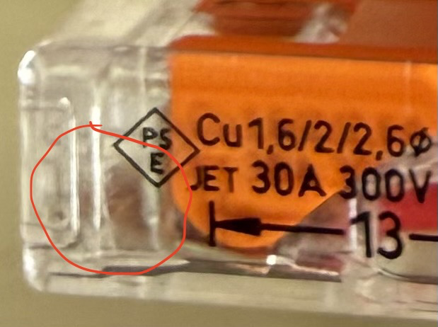

Burned out WAGO connector behind the WFCO 2024 Boondock
pthomas745
pthomas745 Administrator, Moderator Posts: 4,632
Not my trailer, but this showed up on one of the FB pages today. Owner was having problems with battery charging, and intermittent loss of 12V power. He searched hard enough and found this scorched WAGO connector behind the WFCO. I'm trying to get more info…but what would cause a connector like this to fail in this way?
    I managed to get a better photo of the WAGO and asked the owner to see if they can spot where this wire connects to the WFCO.
    MuttonChops Member Posts: 2,032
    pthomas745 said: managed to get a better photo of the WAGO
    Helpful, it is the 30A WAGO Model

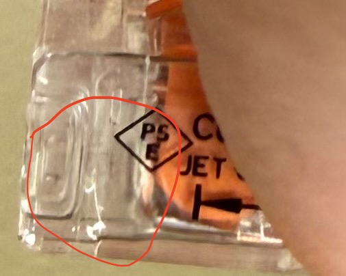

    pthomas745 said:… managed to get a better photo of the WAGO
    In both pics it seems that the problem wire is not inserted far enough. I just test inserted a wire into the same model WAGO. The first image shows the wire visible all the way inside the WAGO. The second shows the clear space because there's no wire there.
    Compare the latter to the FB poster's pics, and you can see no sign of the wire in the problem report.
