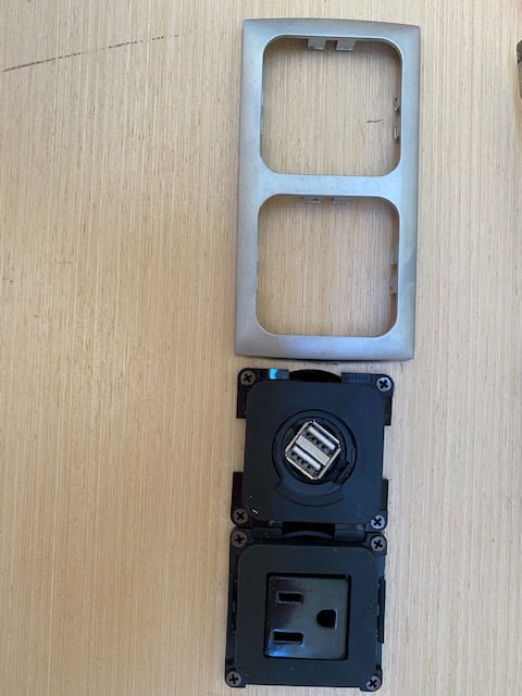

    @qhumberd, I believe you gently pry the cover off of the USB’s and electrical outlet (be very careful not to scratch the wood). There should be a screw between the USB’s and the electrical outlet. Just for safety’s sake, unplug from electrical shore power and turn your battery off while changing the outlets.  Then turn on the battery and shore power on to make sure everything works properly afterwards.

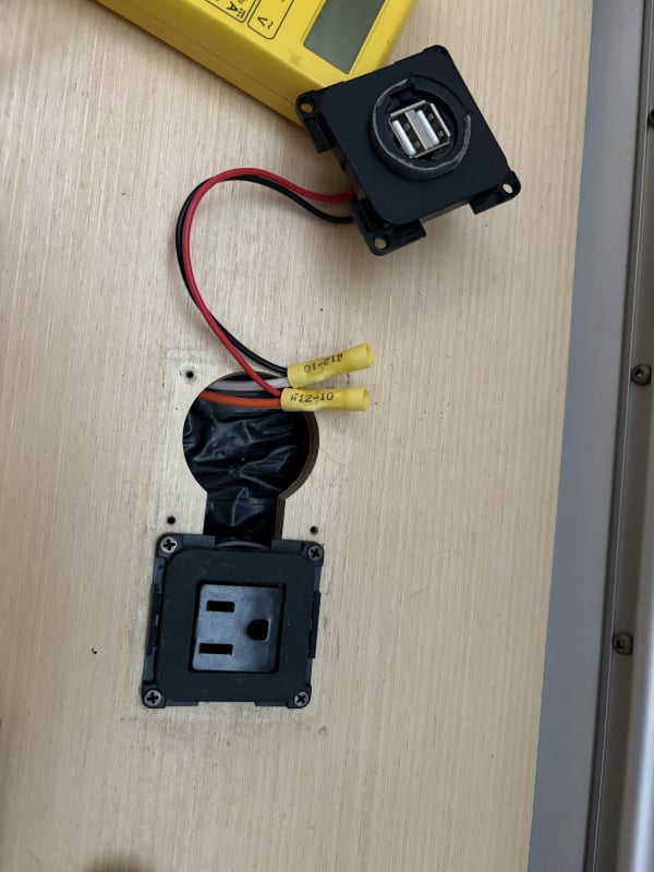

    Posting again to follow up on the repair and upgrade to the dining area USB plug in my 2019 T@B 400.

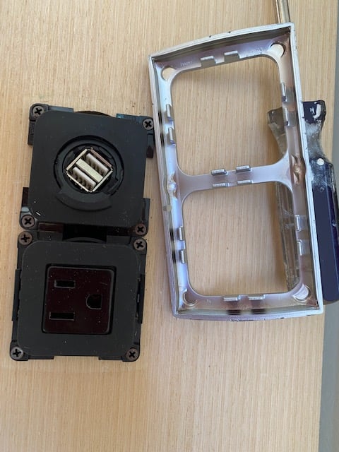

    I ordered another 12V plug and USB combo to place near the front driver side of the dining area, as most later models have now. once I got the damaged USB out I found that some duct tape around the flange was sufficient to secure it back in the holder, and as we don't use that USB often it seemed easier that taking the connections down for a new one.
    When I took off the cover off with a putty knife I found the connections that @Verna had wanted to see:

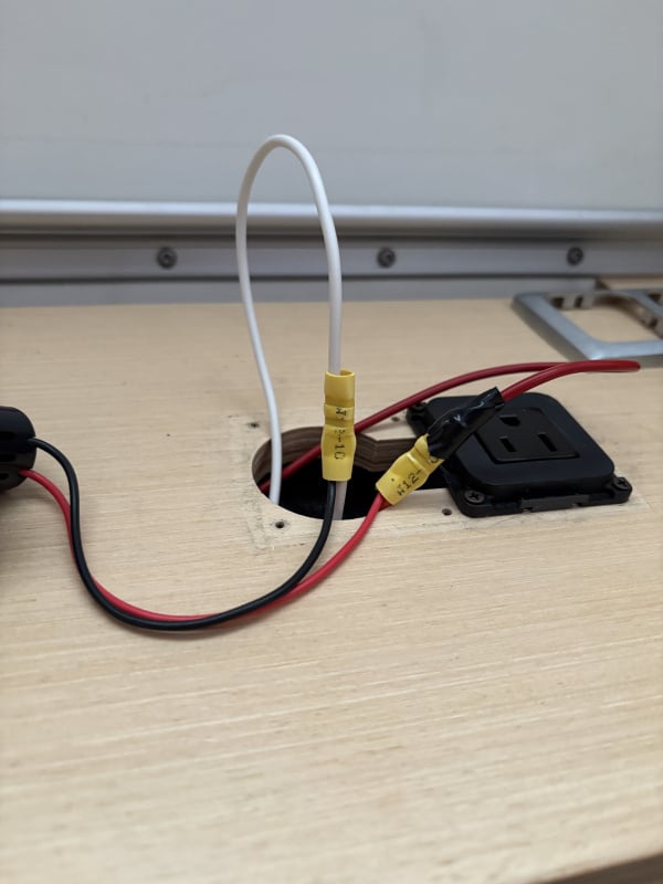

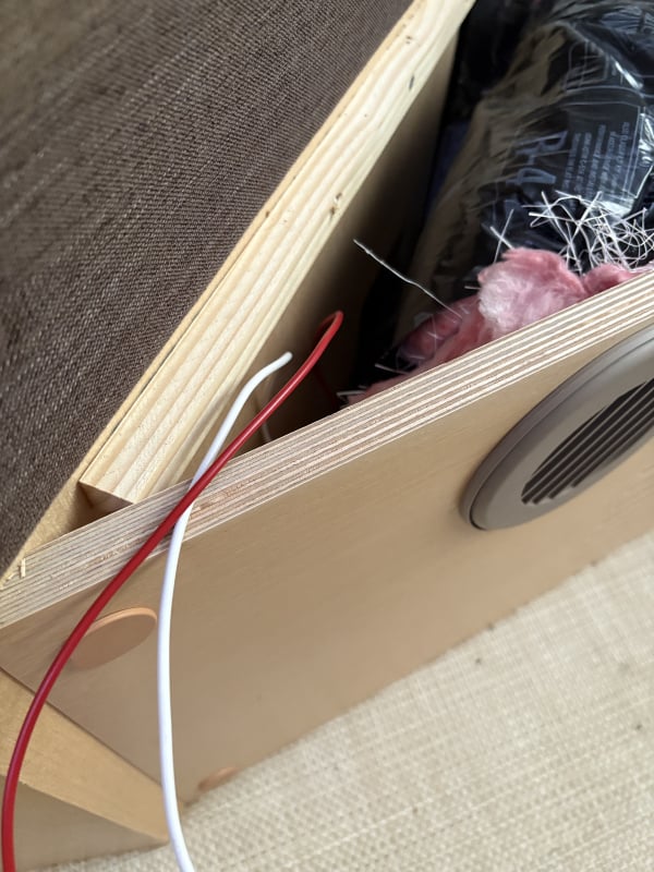

    The broken USB was pigtail connected via a 12-10 butt crimp connector. This provided a way to tap this circuit without cutting any wires. Used 14 gauge primary automotive wire and a crimper to tap the existing butt connector. This is the 15 amp 12V circuit marked as USB outlets on the converter (took out the fuse for the work).

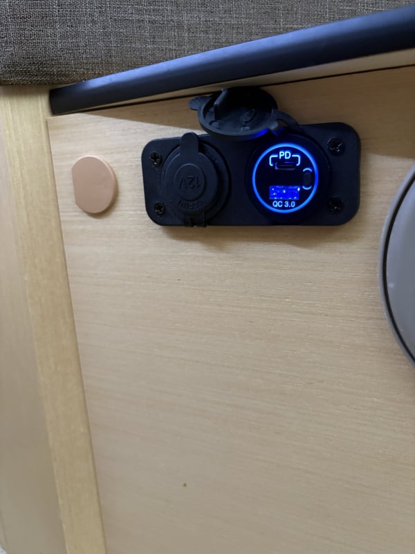

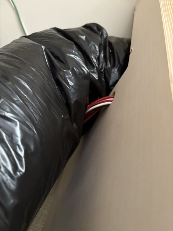

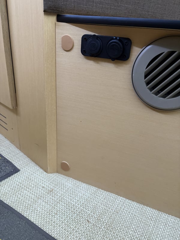

    Ran both wires to the CoolCat compartment without any issues and then decided to place the new 12 V and USB combo on the panel near the vent
    Following the instructions of the new unit I installed with minimal difficulty.  This 12V plug can be used for a variety of functions, and the USB side has the new USB C connection as well. The on off button is nice for confirming when power is on.
    Location is much easier to access and tucks away nicely:
    I got the unit at Amazon a couple or years ago, and it is upgraded now and still available:
