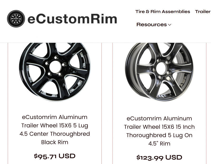

For folk looking for 15x6 inch 5 on 4.5 pattern aluminum wheels like the ones on our 320s Boondock, the online retailer eCustomrim has them. I bought the cheaper of the two thinking that the only visibile difference was the silver accents between the spokes. They looked removable, and indeed they are. They're chrome plated plastic pieces and are easy to remove, making the wheel identical to the one costing nearly $30 more. The wheel was shipped very quickly. I'll need to buy a tire and have it mounted and balanced locally.
