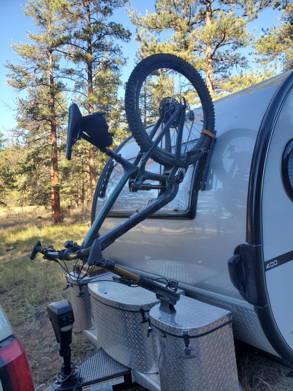

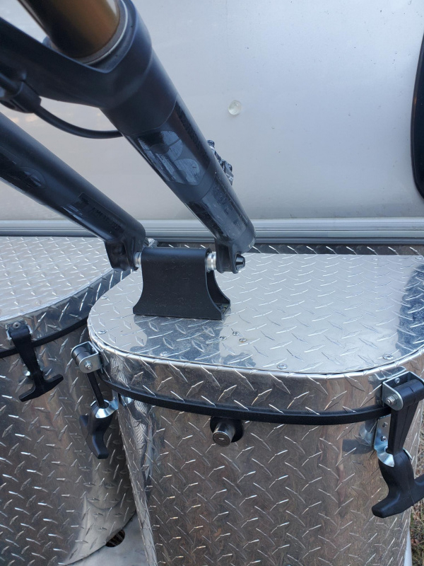

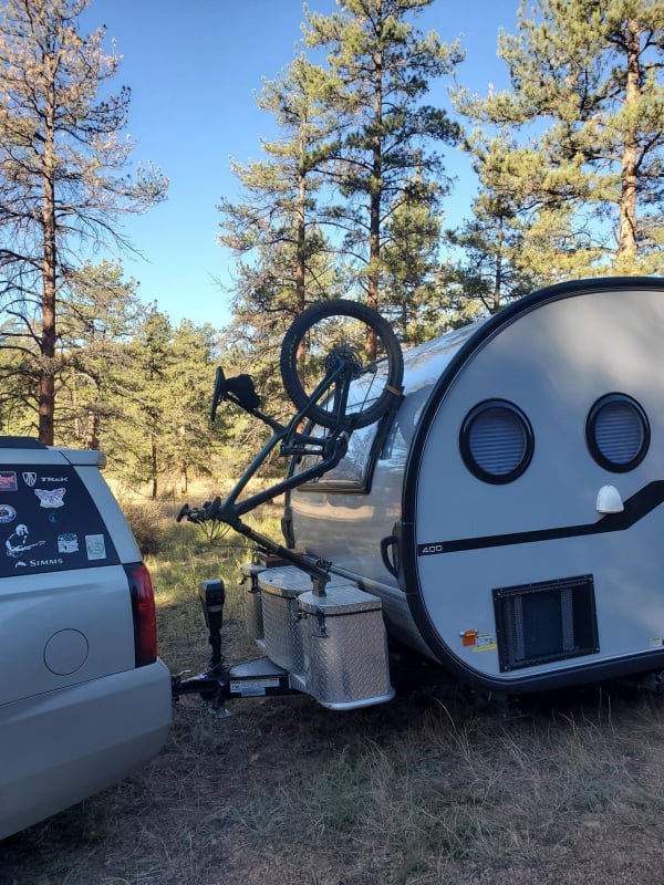

Another option for carrying bikes if you have the new AllPro storage tubs. Rear wheel trays bolt to underlying aluminum cross pieces. Rubber washers as spacers due to curved surface. I used these: https://www.victory4x4.com/product/VBR-BM2-PC-1.html Fork mounts attach to lids of tubs. I used these: https://www.amazon.com/gp/product/B08W8PC31D/ref=ppx_yo_dt_b_search_asin_title?ie=UTF8&psc=1 I reinforced fork mount attachment with some thin steel plates on underside of tub lid. Can open window but not hatch on my Suburban with bikes on. I loosen handlebar screws on bikes in case of any mechanical interference with tight turns. Its easy to get bikes up and down and nice and secure. Have been on a few trips and very happy.
