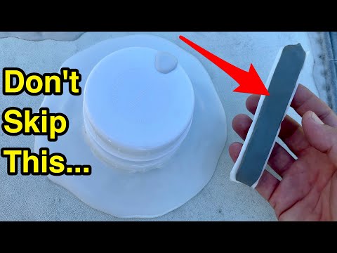

Anyway, I used this video from YouTube.
https://youtu.be/Tr79TZAfi3k?si=Q4XVdHJ_Yw5ev5Fs (if link isn't live, cut & paste into your browser).
The video is concise, and it talks about the butyl tape that is used in addition to the Dicor Lap Sealant. I struggled to get the butyl tape off, but between rubbing alcohol and mineral spirits, I got it completely clean. I'm not going to lie, it took me probably over an hour to get all the goo off without damaging the roof. I used a plastic paint scraper and my hands.
