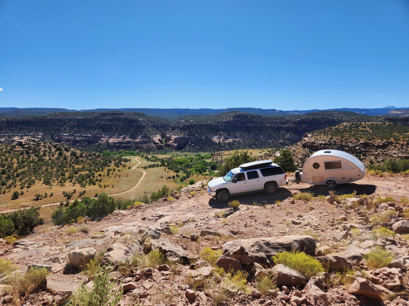

Below is a photo of our T@B on the Rimrocker Trail.  When we're not traveling in the T@B, we're in our renovated 1948 Spartan Manor.  We just returned from 6 weeks going to Mexico and back to see the total eclipse in Durango Mexico.  I've added a photo of that too.  Thanks again for all the great info in the forum.

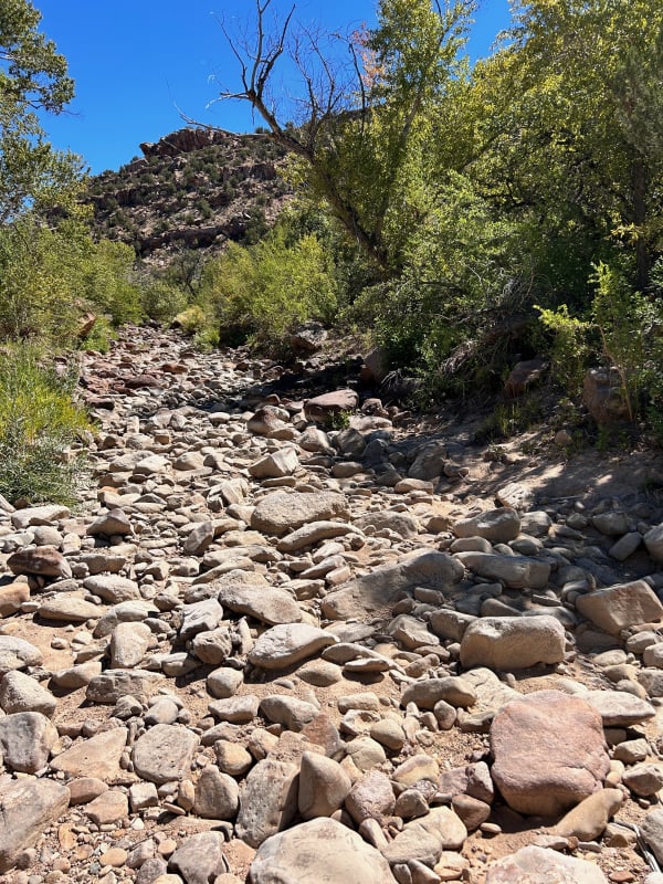

  • rzabel
    rzabel Member Posts: 31
    edited August 26
    It's been a few years (2023), but I'm thinking I'd like to try it again. It was really fun and most of it, distance-wise, is just a gravel road. There are a few real four wheel drive sections, but if you have a properly sized and capable tow vehicle, you will be fine. Make sure everything inside the trailer is secure. The biggest issue we had was finding things from cabinets or shelves on the floor of the trailer. There are some sections that are really rocky and you just need to have patience and go slow or you'll bounce yourself silly. Be prepared to air down tires and pump them back up. If you boondock, you already know what you need to bring when you're a long way away from anything. I had done some work on the tab and truck before this trip, but most of my overlanding upgrades have been done after this once we decided we wanted to do more. Here are some photos:
    IMG_4196.jpeg IMG_4201.jpeg IMG_4206.jpeg IMG_4213.jpeg IMG_9825.jpeg IMG_9826.jpeg IMG_9857.jpeg
