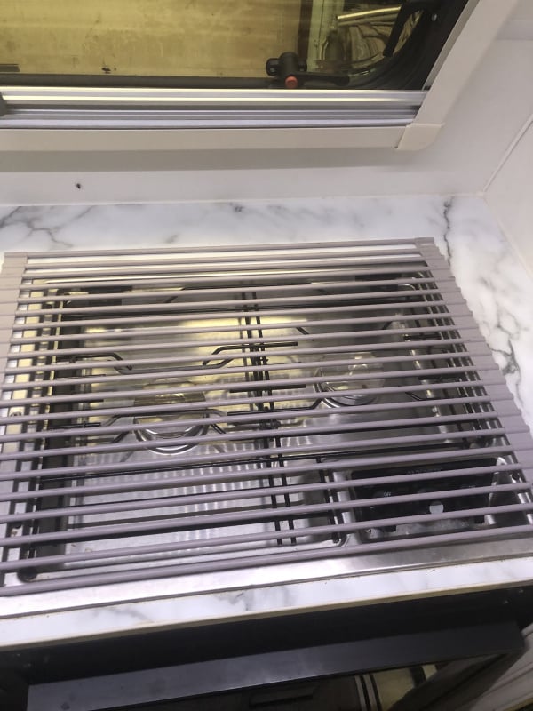

    DaveAnna Member Posts: 66
    This is the mat we use as counter space when not using stove. Have one over the sink, too.

    Silicone roll mat for dish drying. https://www.amazon.com/Hhyn-Roll-Up-Sink-Drying-Rack/dp/B07PBPM7XQ
    Measure the size y’all need. We have 2021 320. You can cut them for custom fit,too
    dave

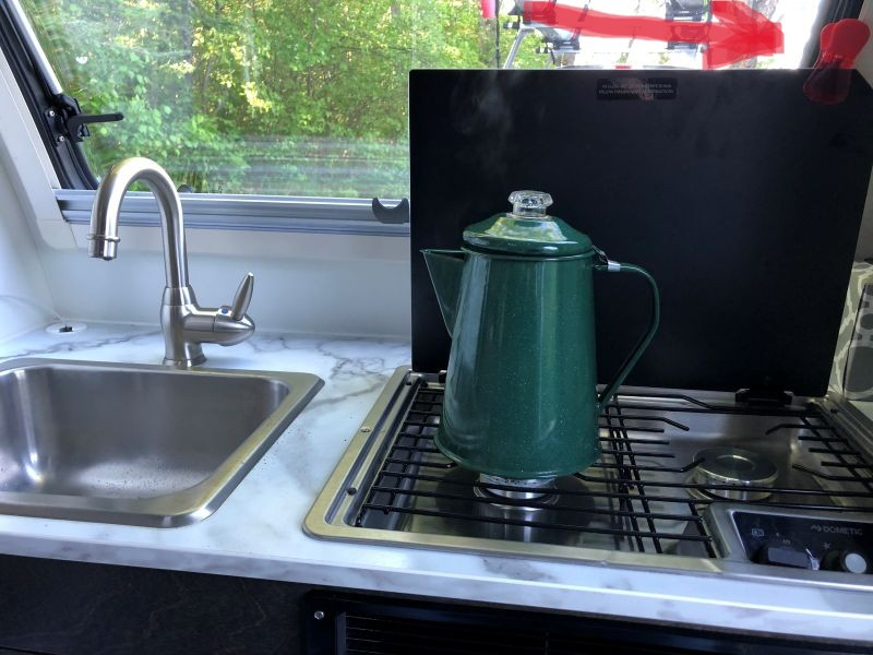

    This, and variations, have been posted here on other posts.  I just used a 'chip clip' on the glass and positioned it to catch the window frame.  Sorry I don't have a better photo.  It always worked for me.  Good luck!
  • TommySax
    TommySax Member Posts: 19
    A chip clip. What a great idea! Same principle as the way my magnets work which I attach in the same spot but probably much easier. Thanks.
