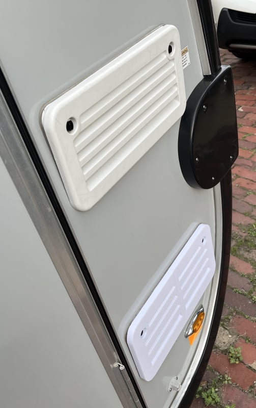

Coming back from a long trip to Texas, we pulled our 2019 T@B 320 north through a STRONG cross-wind in Arizona. When we stopped I couldn't help but notice that the two vents for the 3-way were missing. I called several T@B dealers and I was told they were no longer available. Fortunately, Kelly V. Huffman of Vogel’s RVs on 2500 N State St. in Ukiah, CA 95842 went the extra mile and ordered them from T@B. The replacements were sent directly to me. I recommend this dealer! However, I was determined NOT to loose them again. I searched the web and discovered that this is an RV industry issue, but found no solutions. I thought about it and bought 4 speed nuts, 4 stainless Steel Bolts & Washers and disposed of the plastic fasteners.

I broke one of those little plastic fasteners trying to figure out how they worked, so now I know, lol. I was opening up the lower vent in order to clean out the buildup on the propane pilot which I thought may have needed replacing, but it was just dirty. (It works now) I found these as replacements and they work and fit perfectly. There were some cheaper ones but my understanding from reading the reviews was they weren't the right size or too flimsy.2018 T@B 320S / 2024 Chevy Blazer RS AWD / Phoenix, AZ0
Vogel got me new replacements - but after this experience, I threw them away. Thanks for tip on cleaning the pilot lightReenieG said:I broke one of those little plastic fasteners trying to figure out how they worked, so now I know, lol. I was opening up the lower vent in order to clean out the buildup on the propane pilot which I thought may have needed replacing, but it was just dirty. (It works now) I found these as replacements and they work and fit perfectly. There were some cheaper ones but my understanding from reading the reviews was they weren't the right size or too flimsy.

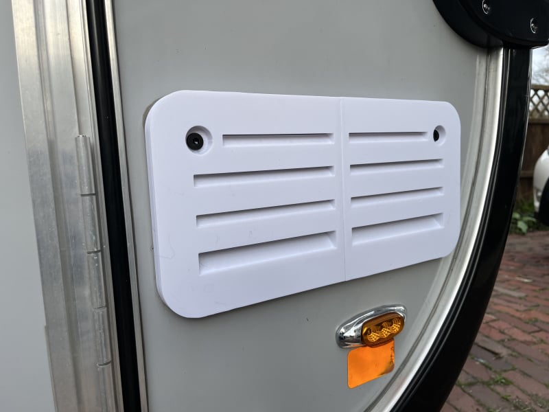

Hi! Im new here, and I recently reverse engineered the vent cover (for a 2018 NuCamp T@B 320 S) and 3D printed a test and it works great!If you're interested please let me know.The cover needs to be printed in 2 pieces, and glued together due to size limitations of my 3D printer.I can also print these in black. If you want a different color, let me knowHeres what I would charge:Labor/Materials = $80 (+Shipping)
(Hardware included)
