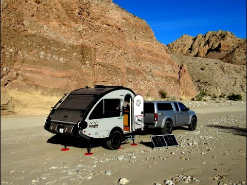

    We boondock our 2019 320 with two 6V golf cart batteries and a portable 95wat solar panel to recharge the batteries during the day. The 3-way ref will run on very little gas. We can watch DVD's at night thanks to the californium sun!
