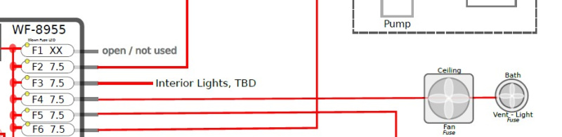

    I agree with @qhumberd check the Power Center fuse with a meter or just replace as it is the most likely cause of both fans not working.
    Reference wiring {fuse # position can vary}
