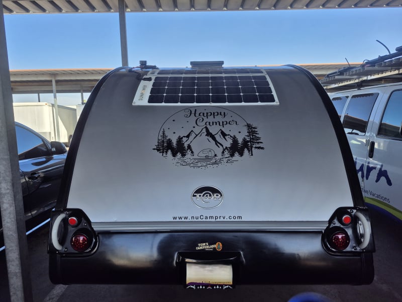

Just a quick update...All of the trim was removed and reinforced with black gorilla tape.The clear caulking underneath the trim was peeled off and redone with Geocel GC28928 Pro Flex RV Flexible Sealant which was recommended by nuCamp.I think it's reinforced well & looks good too. We removed the molding and washed it all, then added the tape to the underside to repair the cracked areas near the screw holes and to reinforce it from breaking again.This was much cheaper and I think just as good as ordering the 4 roof trim pieces for $1,100!
