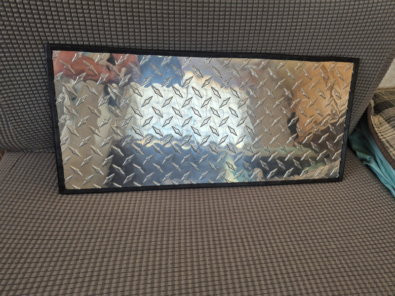

Several years ago, there was a vendor online selling something similar to what I just made here for much more than this cost me.
It's not quite finished as I'm waiting for the rest of the trim ordered on Amazon for $10.
This is for the two vertical edges. It now matches the trim on my plastic tub. I'm quite pleased with the aesthetics of this.
This is a lighter weight aluminum piece of diamond plate that I bought at a local Home Depot for $26 and had them cut for me to size.
They also had the steel which I considered once before but decided against and simply was using a plastic corrugated piece with plastic 3M hooks.
The HD guy made two cuts from my measurements; one horizontally and one vertically, using tin snips so this would be easy enough to do vs the steel diamond plate that requires power tools. I affixed it with 3M 15lb rated Outdoor Velcro. For now, I simply added the two Velcro strips while I wait for the rest of the trim.
I had a leftover trim piece from the tub cutting mod I did for my sewer hose. I doubt it would budge but I decided to remove it for storage (in case of theft) and transport. I like the way it looks and it's an easy and inexpensive mod.

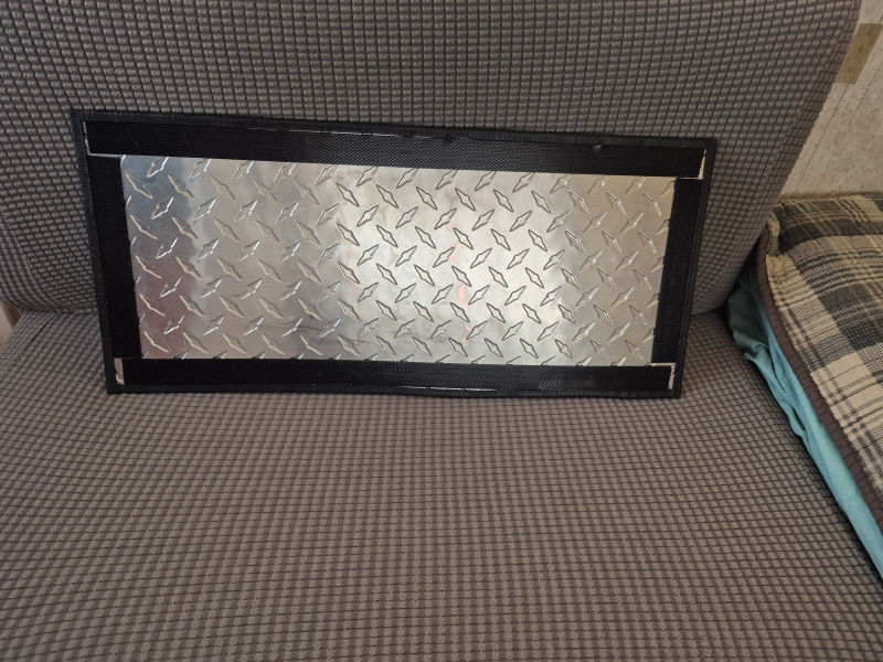

Here's the completed cover with the trim and velcro.
