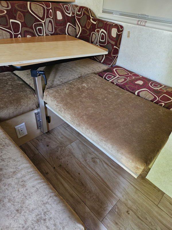

    EBastow Member Posts: 20
    Here's the only picture that I have right now. It's with the shelf brackets up and my 5/8 Baltic birch plywood on top with Gorilla anti-slip pads on it. There is the same setup for the other side also so it can be either half of the bad deployed or all of it.
    Evan Bastow
    Travels with 320-S
  • EBastow
    edited February 19
    Photo of folding shelf brackets,  folded. I put the double-sided finished Baltic Birch plywood under the cushions
    This is 1/2 opened
    Evan Bastow
    Travels with 320-S
  • hammerstone
    hammerstone Member Posts: 31
    Hi Evan @EBastow .
    I am also thinking of the shelf supports but have been considering 6" instead of 12"  Do you find that the pathway between the two beds when both are set up is too narrow to be of use?  I assume your setup would leave about 7" of space, is that about right?
    also, it looks like you had some new cushions made.  Can you tell me about those and their sizes, and how you use them for sleeping vs sitting?
    any additional photos/comments/discussion
     appreciated.
  • EBastow
    Mine opens to the full bed without an aisle between.  You can open 1/2 at a time and then have access, but if the entire bed is open you have to crawl in.
    The cushions are the ones that came with the camper stock.  I just modified the back ones so that I could have the Lagun table support added.
    FYI - I just sold the camper.  My wife needs a larger bathroom, so it wouldn't work for us.  I loved it (easy to tow with my Ford Bronco Sport).
