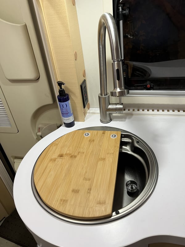

I would agree with qhumberd. The connections on the Dometic fold down faucet are plastic. Mine broke on my 2021 T@B400 over the first winter. We were on the road when we dewinterized, and I was able to find a Lippert pull down gooseneck faucet. Initially I mounted it in the mounting hole on the sink and removed the tempered glass top. Once we returned home I moved it to a counter top mount (drilling a mounting hole) and made a partial cover from a bamboo cutting board. It's been a great improvement.
