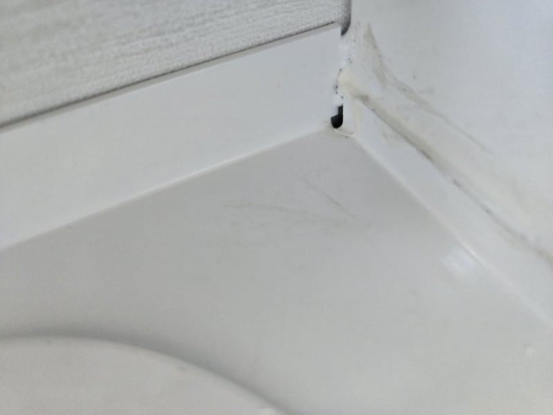

@ImNotThereYet I've posted this a couple times for people who mentioned leaks in their 320s.I had a 320 and had an issue with some water coming out from underneath (and in the camper). Turns out that the compartment where the hose connects to nautilus wasn't caulked in the corners (the ones you can't see). So, if you are facing that compartment-- the left/right corners closest to you. So, if any water gets in there it should drain out the bottom hose inlet, but with the missing caulk, water just went out those holes and came out elsewhere. I was on an up-hill slope (when filling), so mine came out towards the back of the camper. This may not apply to your situation, but I thought I'd mention it just in case. And I'll add, if you have a tight hose connection and no water leaking into that compartment, this clearly doesn't apply to you. This would only happen if your hose connection is loose and water is collecting in the Nautilus compartment (this happens a lot because it's hard to get that connection tight in that cramped space). I had to get my camera and put it in the compartment facing back at me to see the missing caulk in the corners. Those little voids made water come out under the camper and into the floor of my camper (mostly around the nautilus compartment-- under the driver's side seat). A little caulk on both sides solved the problem for me. Just sloppy work at the factory. Oh, and this doesn't explain the problem with only being able to put 5 gallons in. But, I will say that when we were on a slope (uphill), we also had trouble getting the tank truly filled. The display showed full, but the tank was only partially full.

@Basil48192 when I had the issue described above (caulk)-- I had water coming out near the driver's side tire-- like it was coming out around that fender-- and underneath the camper. It was not coming out in the expected overflow (yellow flapper) locations.

@ImNotThereYet -- if you stand outside and face the side of your camper where the nautilus box is-- it's in that compartment. But those little caulk spots are on the side closest to you (still facing). If you could get your head in that compartment and look back in the corners-- you'd see this spot. In the picture below, I'm circling those spots from the outside. You can use your camera to see these by pointing it backwards in the corners. This may be goose chase, red herring material here, but it's worth checking.
Again, my T@B is a 2021, but I had a similar issue that I discovered when I had a bad washer on my hose connection. The water was dripping into the Nautilus compartment, then migrating through the gaps and back into the rear of my camper (storage area behind the folding seat). Like @EasternJL said, the low-point drains are so close to the bottom of the compartment that they have difficulty sealing it. It isn't pretty, but I just pushed as much silicon caulk as I could into each corner.
@Basil48192 and @ImNotThereYet -- just to clarify-- my missing caulk was on the opposite side from yours-- up against the wall closest to you. Those pictures I posted were taken by putting the camera in that compartment and pointing it back towards the corners. So, just be sure to check all four corners -- the ones @Basil48192 is showing and the two on the opposite side which are impossible to see without a camera. It doesn't seem like these spots would cause much of a problem but they will leak to the outside of the camper and inside too.
