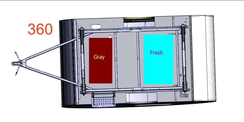

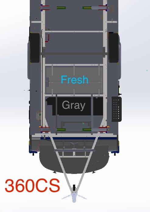

    EDIT August 2025: Better clarity from NuCamp & my dealer on the tank locations for the 360 and the 360CS
    Here are the tank locations for the regular 360.
    The 360CS actually has them both forward of the axle, The light gray tank shown in the following photo is the fresh tank, the dark/black is the gray tank:

    EDIT August 2025:
    Updated info from NuCamp kind of made this comment not relevant as much - but I’ll leave it here for historical purposes.  :)
    I really wish those were reversed. With the CS I feel like the could have been reversed, because there is fresh water consumers and grey water producers both at the front and the rear of the trailer - and I am generally more likely to try and carry around a load of fresh water for longer than I would gray. But on the plus side - with the cassette toilet, we actually use very little of the tanks.  :)
