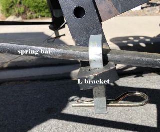

I've just recently come to believe that the dealer from whom we bought our 400 used the wrong WDH. This photo tells the tale:
Note that the spring bar is most definitely not parallel to the L bracket. The L brackets are slowly getting worn down.
The WDH is a Blue Ox TrackPro. I took the trailer to a shop specializing in trailers. The best fit solution got bar & (replacement) brackets to be parallel. But the installation is nothing like what Blue Ox shows it should be. Something new to pay attention to.

    Generally speaking a single axle travel trailer should not need a WDH. The 400 weighs ~3000 lbs dry with tongue weights of 350-380 lbs. Obviously ready to camp it's going to be say 500 lbs more but that's still below the typical 5000/500 lbs where manufacturers recommend a WDH. Many mid-size SUV/crossover manufacturers also state that a WDH hitch should *not* be used. For one the hitch mounts to a relatively thin unibody structure and second having that stiff connection between the trailer and the tow vehicle can unload the rear axle to the point of losing traction. If you look up the specs for various WDH you'll find there are none for a 4000 lbs trailer with 400 lbs tongue weight. The lowest rated Blue OX is for 600 lbs tongue weight, and I doubt the dealer stocks those. Do you know the rating of the hitch you have ?
    In any case it looks like the frame brackets are installed wrong. Can you post a picture of the whole brackets incl the mounting to the tongue ?

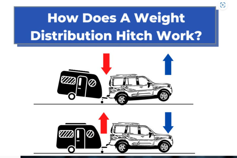

    When I moved up from a 320 to a 360 with my Jeep Grand Cherokee (full tow package/7200 lbs) I looked extensively into a need for a WDH.  My research told me about the 5K pound rule of thumb, but I aso found it can beneficial with tow vehicles with short wheel bases (such as JGC)  and /or if the total trailer weight is more than 1/2 of the weight of the tow vehicle.
    The reason for this is a WDH has very little to do with sway (althought it does provide a side benefit) but rather it does what the name says and redistributes the weight on the tow vehicle from the rear of the tow vehicle to the front.
    What happens, if the combo is not correct and you are getting a pull down in the rear of the tow vehicle to the point where it removes the designed weight off the front wheels, which  leads to poor contact of the front wheels on the ground resulting in driving issues, most likely in wet or snowy conditions.  The  photo below is a bit extreme, but gets the point across.  It essentially "levels" the tow vehicle back to front.  It is more often not visable to the eye.

    The Fastaway looks a lot like the Blue Ox you have and I don't understand why the L-bracket is not vertical.  A further out picture would help us understand that.
