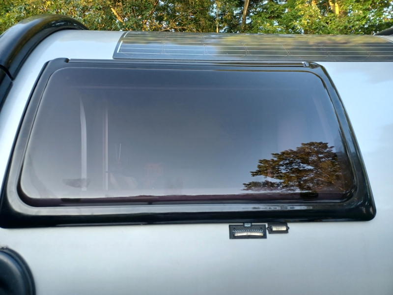

Since acquisition the front window has had a small crack at one screwhole where the side latch attaches to the plexiglass.  This winter it spread and we decided to replace the plexiglass.
Tools: No.2 square drive bit; autobody plastic pry bar and scraper; 1/8" bit to undersized pre-drill; polybutylene caulk and/or tape; naptha for cleanup; rags; stepstool. blue tape and pen; rafter square and tape measure; cardboard for centerline template; magnetic dish for hardware.

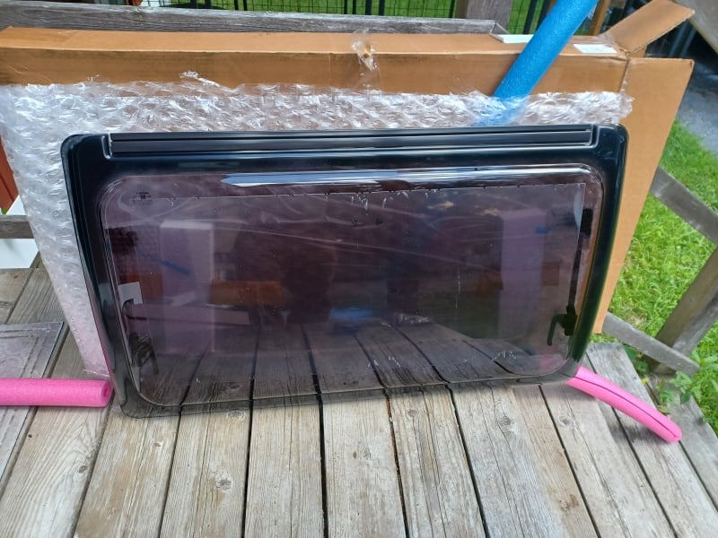

Note from factory....We unfortunately no longer carry the window that came with this trailer so they will need to upgrade to our new tinted version,  320 Front tinted window part number 24426 and price $308.99  UPS 2ND Day Air Shipping estimate $48.02 Total - $357.01
Windows are non-returnable due to freight costs and the high risk of damage during transit. Window orders are processed via 2nd Day Air shipments.
After discussion with Nucamp, ordered replacement from via Missouri Teardrop Campers. It was “in stock.”  The “factory” (Nucamp) did not process the order for five weeks, without communicating that fact despite inquiries.  No explanation.   The window arrived nicely packaged with slotted pool noodles protecting edges, bubble wrap, and heavy box.

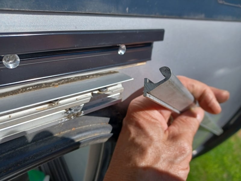

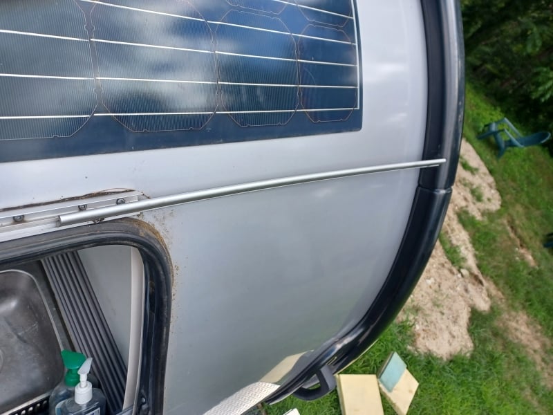

The top mounting extrusion on original and new window differ markedly.
original- two piece aluminum extrusion into which window slides and is centered by set screw.  Attaches with pan head self-tapping screws.
new- one piece top aluminum extrusion into which window inserts face-on when rotated 180deg upwards, and hinges down into position. Extrusion attaches with countersunk flathead self-tappers.
pic- original two-piece below; new one-piece resting above for comparison.  Not in mounting position which was ~5/8" higher than original position.

Unscrewed clasp hardware in window opening, removed top hinge setscrew, slid plexi window off to right.
Then tapped and slid inner aluminum extrusion off to right and out.

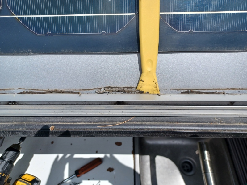

Used plastic pry bar to remove aluminum extrusion and to scrape off adhesive caulk tape strip.
Cleaned up Tab with plastic scraper and lots of Naptha on rag, being careful to not flood the rubber seal that might have adhesive behind it.

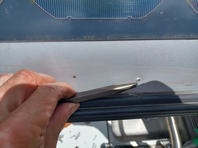

The self-drilling screws pull up and deform a ring of sheetmetal at each screwhole, which would interfere with sealing a new extrusion.  Dimpled with tapered metal punch.  Injected caulk to seal these screwholes in sheetmetal and foam.

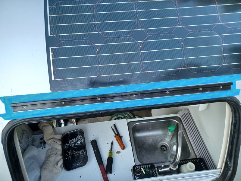

Marked centerline on new extrusion and laid out centerline of opening with great care.  CRITICAL STEP done at 7 pm when the overhead furnace shut down.
Used blue painters tape for temporary marking.
Predrilled (undersize) two endholes through extrusion to TAB and fastened.
Window installs by holding vertically, overextended from normal opening position, inserting bent top into extrusion, and gently rotating window downwards whilst keeping top of window pushed vertically up into extrusion slot.  It took several tries each time I did this which was iterative as I tested, adjusted, and eventually re-did the installation alignment. Stood on my front boxes and was close to over-balancing backwards in order to clear the swinging window in front of me.

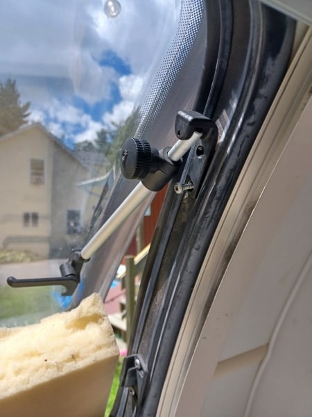

Inside, I hand-screwed the two screws to each side-support and closed and latched window.
A stack of foam scraps spaced the window away from opening so as to create space to install the pivot-mount screws.
Then carefully aligned and hand-screwed the bottom latch receivers atop pair of support spacers.
