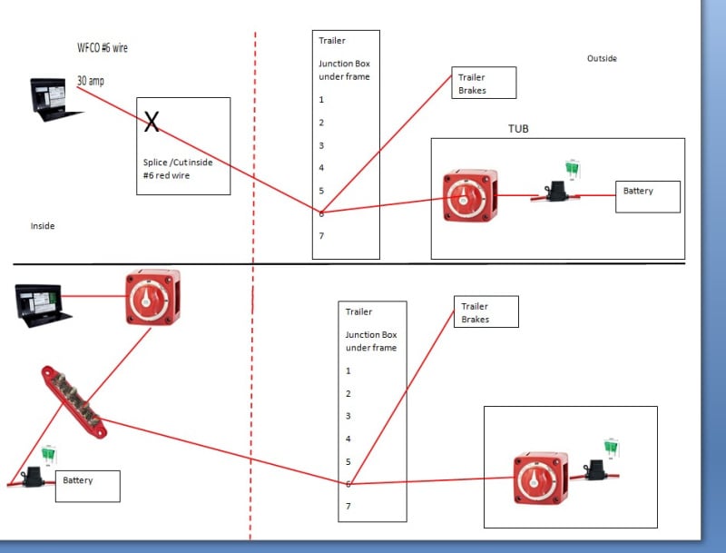

There is a relatively easy way to move the batteries inside without routing wires from the outside to inside (i.e no hole cutting)
If you look at the link to my install, you will see pictures (go to the end of the thread). I had a '21 320 and placed two batteries under the passenger side seat (in front of underbunk AC) and the inverter went under the driver side seat (where the WFCO is located)2025 360 CS

To bring your batteries inside, there is a #6 battery wire coming from your WFCO. This is the very wire the runs directly outside to your battery tub (via the trailer junction box). You would just splice into this inside wire coming from your WFCO. It is essentially using the same wire the routes outside. You just have to still power that wire as it powers your emergency trailer brakes.

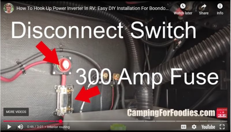

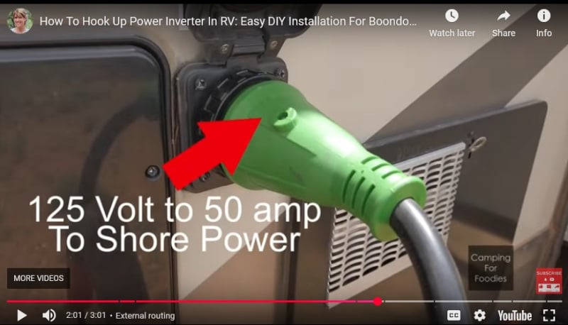

@Yoshi_TAB love the diagrams! I'll consider that splice, but I really want to leave the batteries outside in my tub. I just ordered a new box for them and it arrives tomorrow. I'll have plenty of room for the 2 100ah minis I have. They are group 24 and will fit nicely inside this box. I will have to figure out if I want to bring my inverter inside the trailer. I will add some pics and diagrams once I complete them, but since I'm not adding my wiring into the WFCO (only isolating the converter to it's own 15amp breaker) if I can protect and secure the inverter into the tub, it would make more sense since it will be plugged into my 30amp shore power outlet when being used.Here's an example of one of the YouTubers that did this "simple" inverter setup. They used a larger fuse and they have a 50amp system, but the idea is the same. They also have a little different battery bank and a shunt installed which I won't have. My batteries are blue tooth and so is my mppt solar controller so I can monitor that way.
So, the next question(s) are: on the T fuse holder, there are 150v size and 250v size, which I believe is the max voltage and if I understand this correctly, either will do? You can see HERE there are both options. Do you know which one you used and why?2018 T@B 320S / 2024 Chevy Blazer RS AWD / Phoenix, AZ0 -
