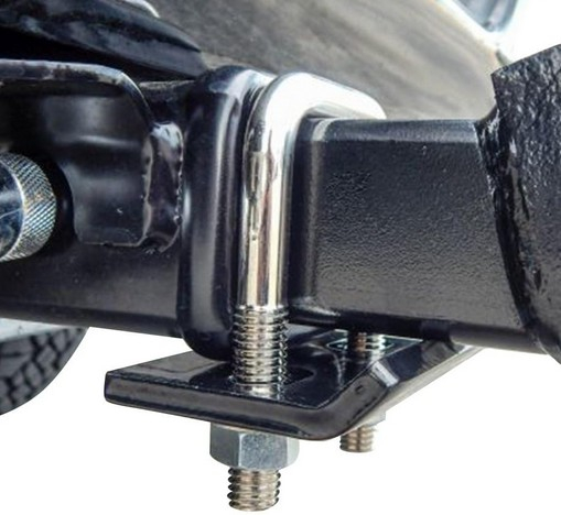

There is another, non-TBC, source of the trailer jerking the tow vehicle; it is Tow Bar in Hitch Receiver play.
Does your vehicle have a Hitch Tightener installed ?
Several brands are available, one Amazon example:
I do not have that and it looks like a good idea to add. But the brake jerk is from the brake being actuated.0
